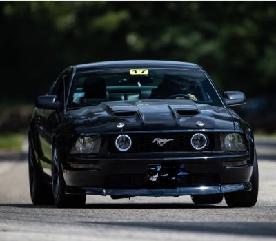

3F12019E-5CED-460D-8FC0-7141838F1BA3.jpeg I’ve had them on my 05 for three summers now. Love them and never had a problem with them. They are not junk. They are wired so that they operate as DRLs.

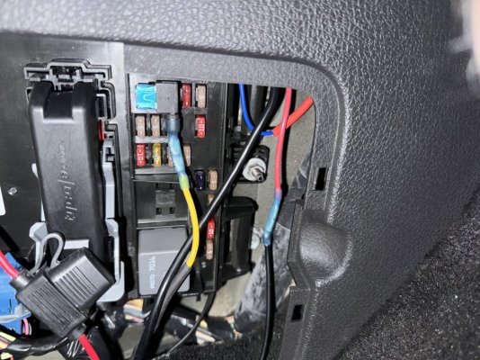

The auto parts store sell an “add a circuit “ fuse. It allows for two fuses in one location. You plug this into SJB and use this to activate a relay. There is an oval rubber plug directly under battery where you can run wire through fire wall. You can get the main power for the lights directly from the battery. Be sure to put fuse between battery and lights. If you can wait until tomorrow, I’ll send a photo of the SJB.
Laga
Aug 10, 2019
1,133
656
Chicago
Here is the location in the SJB I got key on-power on power from. It is the yellow wire. Any connection you make, I suggest using heat shrink tubing with the glue on inside. Especially, if it is under the hood exposed to water. Also, I suggest you install a waterproof connector inline with the lights so you can remove the front bumper easily if you have to. Good luck.

Thank you so much, the SJB is located inside the car? I though it was under the hood! I'll try to find that kind of connector and do similar setup, I always use heatshrink tubing and weatherproof connectors like you, if you do something, better do it right or else don't do it!
DieHarder
Nov 9, 2019
1,862
1,084
The SJB is located behind the kick panel on the passenger side foot well. You have to remove a small panel first. Just pull it towards the driver's side and it should pop out with a bit of tugging.
