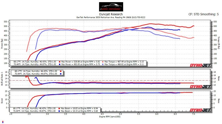

So, unfortunately I could not get my methanol computer to kick on, I have a piezo siren hooked to it so I know it is running. I did manage to increase the hp ~30 rwhp by adjusting the AFR I was seeing it dip into the 10’s at WOT. I bumped the spark up by 2 and every time I did I got a HP increase. Ran out of time, never got the methanol working so stopped adding spark. So disappointed in myself, as soon as I left to drive home the damn snow computer meth started working ugh. It is a weird combination of pushing the 2 buttons for a certain amount of time. I think I’ll just but it on a on/off switch. At one point let the engine rev to 7,000 rpms to see where hp stopped
AdamBorz
Oct 31, 2025
62
41
Bernville, PA
Just rechecked looks like I gained 35 hp just in tuning and I know there is more now that methanol is working.
Still, almost 19 psi at 6940 rpm’s and only 528 rwhp… kinda disappointing actually.

Buddy you should be proud that’s good HP to the rear wheels. Also that flat lunar HP/TQ means that car will pull out in any gear. Congratulations.

Something's still not right.
With 18-19psi of boost plus headers, P&P heads and SPR cams, he should be making way more power.
The boost curve is great so nothing wrong there.
The air:fuel ratio is pretty well dialed in at ~11.5 so nothing wrong there either.
Unless there's anything structurally wrong with the engine itself and it's losing compression (pretty unlikely), that leaves only one thing: very conservative ignition timing.
I'd be monitoring the IATs very closely. Perhaps the heat exchanger coolant pump isn't working properly, and I certainly wouldn't rely solely on water-meth injection to lower the IATs.
Get the IATs down, add more timing, and watch those HP/TQ curves go upwards.

Manifold volume is a tune scalar that basically effects transient fueling delay. A higher MV means a longer delay in injecting fuel. A smaller volume means a shorter delay in injecting fuel.
It really shouldn’t change anything from a power perspective, just fueling transitions.
Agree here.
Another thought - are you running catalytic converters? Perhaps not enough air is getting out…

The tune the car came with has way more aggressive spark tables. the tune in the SCT that came came with says 93octane and methanol. When I bought car it was eating plugs and the kid who owned it was frustrated. The BAP wasn’t working easy fix. That and 2 step colder NGK PLUGS.
Speed shop said they have seen great performance out of 50/50 methanol even pre-twin screw.
Everytime I added spork, hp went up.
Car is showing some knock but I didn’t see it in puffs of smoke out tail pipe (and around 3500 rpm none up top) shop was only running small fan. They said they watch for the puffs of smoke to see if real knock or not??? They do all the time so I’ll take their word.
So the guy I bought it from said the guy that built it said 650 to wheels. Could just be talk or maybe he meant to say 650 to crank then if so I’m close.
I did some hp tuner logs of the dyno runs if anybody wants to see them.
Least it made almost 19 psi of boost and stayed together to 7k rpms.
I think my tune is conservative….

After a WOT run when the fuel cuts out (DFCO) it stutters coming back on. I mentioned it to Lito. Maybe that is because of the 25 he has it set at??
He also has DFCO set to instant so the AFR goes super lean even between shifts. Pops on slow down I don’t like it gonna change it back eventually to way it was.

Cats are on but gutted. I did notice that the mufflers aren’t flowmaster they are flowtech… maybe they don’t flow good enough? Headers and x pipe are Kooks
