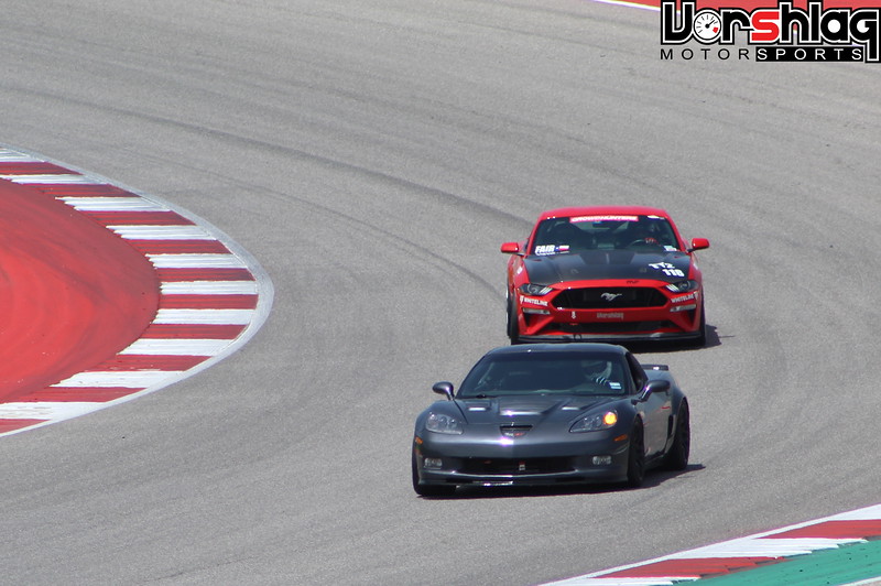

    I had to back off then for a bit, but since we both had a few fast cars behind us, I kept pushing his mirrors.
    [​IMG]
    That forced a mistake, he drove wide out of T11 and pointed me by, but by then I had lost all momentum in that turn (was 8 mph down in the braking zone into T12) and that lap was a throw away (2:34.4).

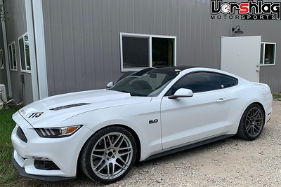

    At one of these TT events, a friend's white S550 2015 Mustang GT got smashed up, so we jumped in to help complete the repairs, and amazingly got it back on track in 3.5 weeks - just in time for him to take it to SCCA TT Nationals. Our black 2015 GT build (#Trigger) went to the body shop for measurements and had a few things "borrowed" to fix the smashed up white 2015 GT, shown below left.
    [​IMG][​IMG]

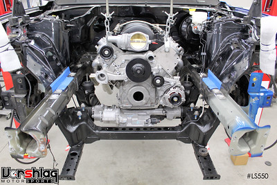

    Once this 2015 chassis came back with a clean measurement test, we began the LS engine swap and moved much of the 2018 GT's raciest bits over. This is now rolling on MCS RR2s, SPL arms, 19x11s, and much more. First we will talk about our S550 brake cooling upgrade that has been hugely successful in the last month since it went into production.

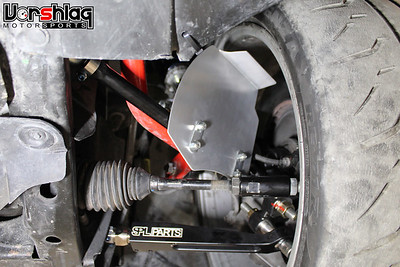

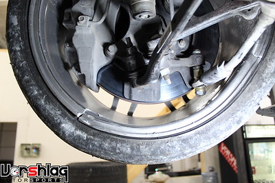

    FRONT BRAKE DEFLECTORS
    [​IMG][​IMG]
    Since my last post, our S550 front brake deflectors are in production and selling like hotcakes. We now make this for 7 different varieties of S550 front brake / control arm setups, including the 4-hole with U-bolts (shown above) and a 3-hole version (see below).
    [​IMG][​IMG]
    This pair of images above show our final S550 brake deflector version next to the OEM Performance Pack plastic flap. The PP cars have a front control arm with 3 threaded holes that this will replace. The same version also fits the GT350/R with the same style 3-hole control arm, and we make a 4-hole version that fits the cars with a control arm that has no holes, like the base GT, V6 and Ecoboost as well as aftermarket arms like the SPL Parts arms - all of which are shown below in different sections.
    [​IMG]

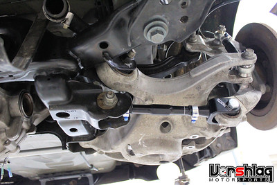

    We make these deflectors in-house, and cut out a batch of these every few days, so if you order it should ship pretty quickly. We have started including some M6-1.0 bolt hardware for all kits because we have seen that the OEM hardware tends to break when removed. Be prepared to drill out the old stuff and re-tap. Likewise the GT350/R arms have the 3 holes in the arms but they aren't tapped - an M16-1.0 tap takes care of that. For the non-PP / non-Shelby Mustangs and aftermarket control arms we include the U-bolt kit, which allows you to attach the deflector to the arm that way.
    [​IMG][​IMG]
    We will also continue building and selling our traditional S550 (4") and S197 (3" and 4") ducted hose front brake cooling packages, for those who don't have undertray tunnels or a way to add them, or don't trust our brake deflector test data (or Marco's more extensive Ford test data). Hey, you want to spend 3 times as much to use the old school brake ducting with hoses, we'll sell them to you. We should have our S197 brake cooling deflector solution in a few weeks as well as a few other Mustang models we are working on with Marco Garcia.

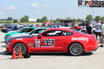

    But on Sunday we saw the D&E results - and our car did terrible. Ranked 63rd out of 67 cars that were judged! Something on this car pissed off the judges, not sure what. There were multiple BONE STOCK Mustang GTs and Shelbys and Camaros that outscored us by 30 places or more. This poor placement really chapped my ass. A car with a LOT of modifications, prototype parts, and bespoke equipment gets outscored by 30 places by a showroom stock Mustangs? Come on...
    "ItS yOuR pReSeNtAtIoN!" some said. Look, I'm not a noob when it comes to public speaking or giving presentations - this was just some weird scoring guidelines. Whatever - the car show portion is the one I hate the most in Optima, and since I'm a bit vocal about it, I guess this is my punishment. We probably need to bring stuffed animals, mini models of our car (yes - they were there), underglow LEDs, big speakers, chrome doo-dads and tacky wraps.
    [​IMG][​IMG]
    Some of the excuses I heard were missing carpet in the back seat - which was done to make room for the 4-point roll bar. If that is the case, they are literally discouraging safety upgrades to justify the car show crowd. When somebody rolls a car and they get injured due to their car show emphasis, I'm not gonna say "I told ya so", but I am going to think it.

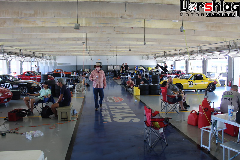

    The garages at TMS are super nice and you really MUST rent one if you run an event here. These are the same garages that NASCAR use when they run this track in their series. Spacious, bathrooms on the ends, roll up doors and power. Plenty of room to spread out your stuff, chairs, cooler, etc.

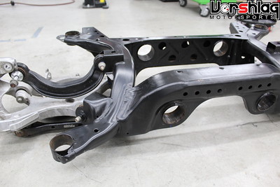

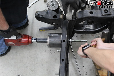

    TIPS FOR REPAIRING A CRASHED S550
    We talked about the repair work to Matt's car online back in August (after he gave us permission), and it was a bit of a thrash on our end + the work needed at Heritage to get this car back up and running in less than 4 weeks. Why not share the work in chronological order here? There were just 5 weeks to repair this car and make it track ready again before the SCCA TT Nationals. Some asked why we stopped everything at our shop to attack the work on this car? Let me explain.
    [​IMG]
    It turns out this car is kind of special to us, for multiple reasons. It was formerly owned by Brian Matteucci, who is an old friend of mine from college, and who's company (Motor-Force Engineering) we bought in 2006. We had Brian use this 2015 GT for our first S550 camber-caster plate for the OEM style spring. And later his 6th gen 1LE for our first 6th gen camber plate as well. Then he sold this car to Matt Givens, his endurance racing team partner - who we got to know at several events. Super nice guy, and a quick driver. He still rocks the Vorshlag banners on his car, too.
    [​IMG][​IMG]
    Matt bought the car from Brian a couple of years ago and has upgraded to MCS TT2 coilovers that he got from us, added a 4-point roll bar, Sparco racing seats, long tube headers + CAI, and more. Last year he ran the car at the NOLA round of Optima, and did well. In 2019 he began running the car in National SCCA TT events across the country and cleaned up there, setting FTD at more than one event.
    [​IMG]
    In this car Matt had been was racking up the TT wins in the SCCA's unique classing structure by going to events on the road, and we really wanted to see him take this car to the 2019 TT Nationals at NCM. We had originally talked about going to that event in our 2018 GT, and the June Optima event was a sighting trip for this TT Nationals for us. After starting our 2015 Mustang project we decided to skip TT Nationals and instead support Matt.

    We briefly installed the 3-bolt S550 brake deflector (above right), for pictures. We had planned to replace the janky ducted backing plates that had some of the worst corrugated hoses (above left) we had ever seen - routed up and over the arms like we see some do. Not his fault, this is how this product is sold.
    [​IMG][​IMG]
    We had the car in the air and could not see why the wheel was offset to the rear. Maybe the front subframe was bent? That's a big expensive part ($900) and takes a lot of time to install. The SCCA TT Nationals was only days away. We punted and got some adjustable front control arms with spherical ends from our buddies down at SPL Parts in Austin, which arrived the next day. As Brad was installing these he pulled the factory TC rod, the second lower control arm that looked perfect... and wow. We uncovered the mystery.
    [​IMG][​IMG]
    the spindle was badly distorted at the mounting hole for the TC rod, as was the ball joint end there and the bolt at the subframe end. So it didn't need a subframe, just a new spindle and arm. We rushed our local Ford dealer and they got a spindle quickly for only $220. Something to look closer at in a car that has had an impact - we will inspect these more closely next time.
    [​IMG][​IMG]

    Those that question the reasons behind an LS swap just need to look at the image above. I shot both pics myself, from the same height/angle, and cropped the images to show the same width of each chassis. Both S197 and S550 engine bays have the same distance between the strut towers (roughly 36"). The Coyote in the S197 (left) is a pretty snug fit, but the LS (right) in the S550 has room for days around, above, and in front of it.
    [​IMG][​IMG]
    We are still setting the exact fore-aft placement of the engines + trans, but this image above is pretty close to perfect. This puts the T56 Magnum XL shifter inside the stock shifter hole and 85% of the engine behind the front axle centerline. With a custom "one off" kind of cut and slash install, sure, we could cut the firewall and tunnel. This would let us move the engine back even more, maybe even use a shorter T56 Magnum or Magnum S... but that would defeat the purpose of this build: to make an LS swap kit that was really 100% bolt in. To sell LS swap parts people might buy (we have had a massive response to news of this swap).
    [​IMG][​IMG]
    The "Phase 1" engine is a mild 383" aluminum LS that will use a wet sump oil pan and an Accusump, so we are testing the swap with a variety of LS oil pans for the swap to be built around. The 4th gen Camaro LS pan fits easily, as does this steel, baffled pickup, 7 qt Summit oil pan. I will show more of this pan later.
    [​IMG][​IMG]

    During driveline angle tests I noticed something odd, and it turns out the rear subframe wasn't even fully bolted in, and one hole was cross threaded. So the subframe came out to be able to re-tap that hole, which went cleanly. Normally I am not a big fan of doo-dad mods like "subframe/diff bushings", as their value is dubious at best... I never felt like the rear bits were flopping around on our 2018 GT. But this car is "going to eleven", plus it had some really worn, aged, cracked bushings back there.
    [​IMG][​IMG]

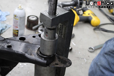

    While the subframe was out we decided that the diff mount and subframe bushings (8 in total) needed an upgrade. So we ordered the Whiteline bushings to swap into their places. The extraction of these 8 mounts is a REAL CHORE if you don't break out a SawsAll, which can easily cause damage to the somewhat thin metal on the steel subframe assembly. We made some custom tools and tried a number of tricks getting the old bushings out - which I will show in more detail next time.
    [​IMG][​IMG]
    After the many hours of work removing the old ones, the new bushings went into the subframe in less than 20 minutes. An all new SPL Parts lower adjustable toe link went in, replacing the stock bits here (see above right). This toe link is a brand new design from SPL and was not installed on our 2018 GT.
    [​IMG][​IMG]
    SPL Parts were also swapped into this spherical/adjustable vertical link shown above, which replaced the stock rubber bushed piece. We transferred this part right over from the 2018 GT.
