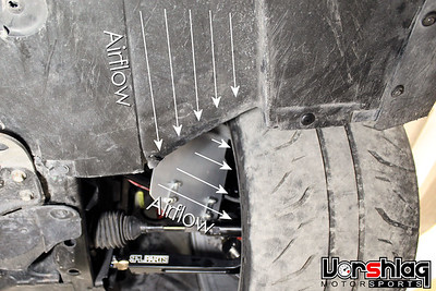

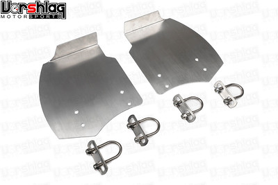

FRONT BRAKE DEFLECTORS
Since my last post, our S550 front brake deflectors are in production and selling like hotcakes. We now make this for 7 different varieties of S550 front brake / control arm setups, including the 4-hole with U-bolts (shown above) and a 3-hole version (see below).
This pair of images above show our final S550 brake deflector version next to the OEM Performance Pack plastic flap. The PP cars have a front control arm with 3 threaded holes that this will replace. The same version also fits the GT350/R with the same style 3-hole control arm, and we make a 4-hole version that fits the cars with a control arm that has no holes, like the base GT, V6 and Ecoboost as well as aftermarket arms like the SPL Parts arms - all of which are shown below in different sections.
We make these deflectors in-house, and cut out a batch of these every few days, so if you order it should ship pretty quickly. We have started including some M6-1.0 bolt hardware for all kits because we have seen that the OEM hardware tends to break when removed. Be prepared to drill out the old stuff and re-tap. Likewise the GT350/R arms have the 3 holes in the arms but they aren't tapped - an M16-1.0 tap takes care of that. For the non-PP / non-Shelby Mustangs and aftermarket control arms we include the U-bolt kit, which allows you to attach the deflector to the arm that way.
We will also continue building and selling our traditional S550 (4") and S197 (3" and 4") ducted hose front brake cooling packages, for those who don't have undertray tunnels or a way to add them, or don't trust our brake deflector test data (or Marco's more extensive Ford test data). Hey, you want to spend 3 times as much to use the old school brake ducting with hoses, we'll sell them to you. We should have our S197 brake cooling deflector solution in a few weeks as well as a few other Mustang models we are working on with Marco Garcia.

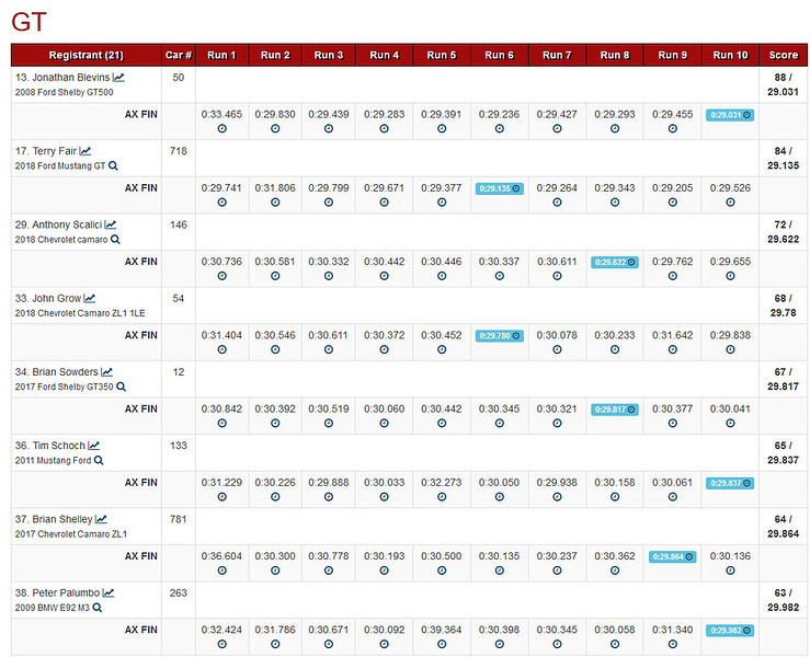

Ran a little quicker on my 5th run, then my 6th was my quickest of the day with a 29.1135 sec time. No better on run 7 or 8 - was really hoping for 28s, which is what most of the fastest cars in other classes were running. I was still in the lead and once everyone in GT had run their 8 runs. I thought this might be the one event we win in GT class, as I tend to do better at Optima in the autocross than any other timed competition.
Then we got in the line for D&E again, and waited... waited... waited... Then we noticed cars were making more autocross runs. Wasn't announced well, but when pressed the organizers admitted that yes, all cars were going to run two more runs. Crap. We had 3 cars ahead of us in the D&E line, but we were going to miss our chance at the additional "bonus" autocross runs, so we hopped out and rushed to grid.
I ran two nearly identical times, 29.2 and 29.5, no help. Blevins improved to a 29.0 on his 10th and final run, bumping me to 2nd. Then my 29.1 run disappeared from the results, so I had to go take my time slips and a screen shot from live timing system to the Timing and Scoring trailer, they sent me to the Optima trailer, then the next day they finally found this time. Didn't show up on the autocross results until Sunday, but I was finally shown in 2nd almost a tenth of a second off the lead. Falling back to a 29.2 time have changed the class order, but it would effect points - as they give points for placements based on ALL cars at the event in a particular segment.
Frustrating to lose an autocross on run # 10, but hey, its Optima - they try to give people as many runs as they can, so it can lead to time drops throughout the day. We're about 400 pounds heavier then the purpose built Blevins car (which is near the 3200 pound GT class minimum), but I still should have driven better. The 4.09 gearing worked really well for us, ideal for 2nd gear, and I hoped that could translate to a good performance in the Speed Stop on Sunday.

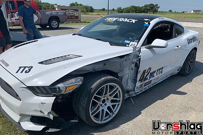

Normally I don't show it when "bad things happen", and I want everyone reading this to know that any car-to-car contact in Time Trial is super rare. Since coming to NASA TT events starting in 2006 I have witnessed car-to-car incidents only 3 times in probably 100+ TT events. It happens in HPDE more than TT, honestly. But not talking about this incident would be dishonest, because we knew both drivers and helped repair one of the cars. This happened in the lone TT session after I came in, and I missed all of the action. All was not going smoothly in the middle of the pack, where a massive log jam was brewing. Erik from HPR and Jason from Vorshlag saw it all go down from the viewing stands, who gave me their eye witness accounts. I also talked to both of the drivers afterwards.
The lead car (I'm not getting into all of the who or what on that) went a bit fast through T7 and spun off track left at T8, heading towards a concrete wall along that side of the course. I have seen many cars impact that wall and it always ends up with a totaled chassis. This driver tried to avoid the wall (smart) but after pointing the car away from that near certain impact, he came back across track and tagged the car behind - Matt's white 2015 Mustang GT, shown above. I will cover the repairs to this car below, but long story short: both cars were damaged but both drivers were fine. Both cars had more than minimum safety gear and the seats, harnesses, HANS and roll bars did their jobs well. SMART.
I know both drivers well and neither was overly upset at the other - it was just the result of very close confines plus a spin that got a little out of hand. Matt said he thought the car ahead was going wide to let him pass as it went into T8, so he accelerated to pass on the ritht, then noticed the car coming back across track. He then dove way off track right, to try to avoid - they didn't make contact until 10-20 feet off the track, in the grass. It was the right move to make, given what he could see, just some bad luck.
The session was black flagged. When I heard what had happened I ran over to Matt's paddock area with a floor jack, as the car was being dropped off the flat bed wrecker. He was fine, but his Mustang was a mess. It had popped air bags, the LF wheel was crunched into the body, and the LR corner was banged up. Did not roll. Matt had planned on being at SCCA TT Nationals just 5 weeks from that day, so we had to act quickly to try to make that happen. Jason and I did a quick triage, took some pics, then rolled into action. I sent pictures to our paint an body guru, Shiloh at Heritage Collision - who has fixed a number of SCCA and NASA race cars after incidents, and paints all of our project cars. He felt like it could be fixed, so the work was scheduled. Not going to be an insurance job.
We had Matt call a flat bed wrecker, then I had Amy meet that at the shop, to show where to drop the car. We had some OEM parts from our recently acquired 2015 Mustang we could donate. Matt was a bit in shock but we took care of everything else and the car was at Vorshlag about 60 minutes later. We helped Matt pack up his stuff, then he and Brian Matteucci headed back home to Houston while we waited to see what was going to happen the rest of the day.

We talked about the repair work to Matt's car online back in August (after he gave us permission), and it was a bit of a thrash on our end + the work needed at Heritage to get this car back up and running in less than 4 weeks. Why not share the work in chronological order here? There were just 5 weeks to repair this car and make it track ready again before the SCCA TT Nationals. Some asked why we stopped everything at our shop to attack the work on this car? Let me explain.
It turns out this car is kind of special to us, for multiple reasons. It was formerly owned by Brian Matteucci, who is an old friend of mine from college, and who's company (Motor-Force Engineering) we bought in 2006. We had Brian use this 2015 GT for our first S550 camber-caster plate for the OEM style spring. And later his 6th gen 1LE for our first 6th gen camber plate as well. Then he sold this car to Matt Givens, his endurance racing team partner - who we got to know at several events. Super nice guy, and a quick driver. He still rocks the Vorshlag banners on his car, too.
Matt bought the car from Brian a couple of years ago and has upgraded to MCS TT2 coilovers that he got from us, added a 4-point roll bar, Sparco racing seats, long tube headers + CAI, and more. Last year he ran the car at the NOLA round of Optima, and did well. In 2019 he began running the car in National SCCA TT events across the country and cleaned up there, setting FTD at more than one event.
In this car Matt had been was racking up the TT wins in the SCCA's unique classing structure by going to events on the road, and we really wanted to see him take this car to the 2019 TT Nationals at NCM. We had originally talked about going to that event in our 2018 GT, and the June Optima event was a sighting trip for this TT Nationals for us. After starting our 2015 Mustang project we decided to skip TT Nationals and instead support Matt.
So it's Monday morning after the TMS incident and Matt's car is parked in front of our shop. It was slid off the roll back there and won't roll because the wheel is crammed into the strut, and the LF control arm is broken. Brad installed the LF arm off of our 2015 GT, swapped on one of my spare 19x11s, and it was driven into the shop. First step of many!

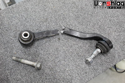

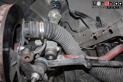

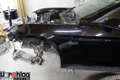

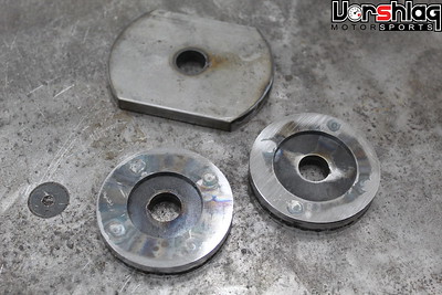

We noted a jacked up front alignment - once on the lift we could see that the steering rack was partially broken and the tie rod was very bent. The transmission crossmember was also shattered. The 650 pound engine + transmission sits on sloppy hydraulic mounts, and when the car was hit from the side, the drivetrain moved as a big undamped mass, which shock-loaded the 2 pound cast aluminum transmission crossmember. Boom!
The LF wheel took the brunt of the car-to-car impact, which drove it into the strut, which bent the strut housing and shaft. The fender was shredded - the fronts are aluminum and very flimsy. We stole the LF fender off my black 2015, to save time and money. Took our driver's door, too.

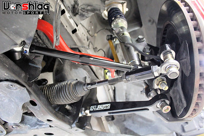

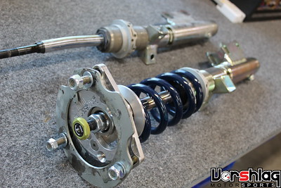

Luckily we had a set of S550 MCS TT2 coilovers in stock (only set in the country we could get our hands on that day), so we stole the front strut from this kit to replace the badly bent unit on his car. We inspected the camber plate and surprisingly it was perfect, so that and the spring were swapped over.
The steering rack from my 2015 looked good so it replaced his broken rack (left side mount had broken off) plus the new suspension bits went in quickly. One of the inner fender reinforcements was missing from this white car - the big black panel shown above. This is a foot intrusion panel that bolts the frame to the inner fender structure. That being in place would have mitigated some of the damage, and Shiloh wanted this piece to be able to pull some of the seam back in place and align it - so that came from my 2015 GT as well.
We worked on the car for only 3 days (Aug 19th-21st) but had the car to Shiloh rolling and driving - with a replacement door and fender - on Day 4. After I dropped it off his team got to work located the parts needed to replace the busted headlight, bumper cover, and do the bodywork and paint repairs.
It was at Shiloh's for about 3 weeks where they bodyworked the rear fender and bumper cover (secondary impact), pulled the front inner fender structure back into place, then installed the LF fender and door from my black 2015.
They primed, painted, and cleared the left side of the car + bumper cover. It looks great but they noticed an issue with the left side wheelbase - the front wheel was pushed rearward and didn't line up with the fender arch.

Bit of a head scratcher, but Shiloh noted that this happens a lot on cars that get hit - the weight of a driver and/or passenger will push the floorpan out of shape as the seat deforms in the crash. We looked and my 2015 passenger floor is buckled the exact same way! After pulling carpet and some other things out of the way it took about 20 minutes with some sections of 2x6" wood and hammers to persuade the floorpan back into shape. The frame was perfect, just part of the floor distorted. Once that was pushed back our seat bracket lined up perfectly and went in.
We briefly installed the 3-bolt S550 brake deflector (above right), for pictures. We had planned to replace the janky ducted backing plates that had some of the worst corrugated hoses (above left) we had ever seen - routed up and over the arms like we see some do. Not his fault, this is how this product is sold.
We had the car in the air and could not see why the wheel was offset to the rear. Maybe the front subframe was bent? That's a big expensive part ($900) and takes a lot of time to install. The SCCA TT Nationals was only days away. We punted and got some adjustable front control arms with spherical ends from our buddies down at SPL Parts in Austin, which arrived the next day. As Brad was installing these he pulled the factory TC rod, the second lower control arm that looked perfect... and wow. We uncovered the mystery.
the spindle was badly distorted at the mounting hole for the TC rod, as was the ball joint end there and the bolt at the subframe end. So it didn't need a subframe, just a new spindle and arm. We rushed our local Ford dealer and they got a spindle quickly for only $220. Something to look closer at in a car that has had an impact - we will inspect these more closely next time.
Matt was OK with the upgrade and we put the SPL arms on - he had sphericals on one end of the TC rod already, so this wasn't going to be a change in "NVH" for him. The SPL arms are very adjustable and allow for more camber, caster, and slight wheelbase changes. New Whiteline swaybar end links replaced some lower end bits he had in there, so now the suspension was refreshed and it was time for a gross alignment.

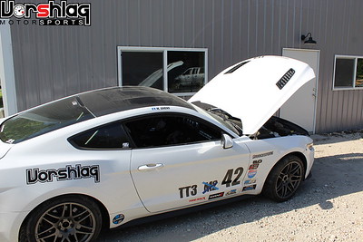

PREPPING 2018 GT FOR SALE
At the time of this writing our 2018 Mustang GT is for sale, as shown below. If this classified ad is still showing "for sale", then it is still for sale. When you go there and it shows "SOLD" then its sold. That should hopefully cut down on 300+ questions over the next 12 months. I hope. #IsItStillForSale
I made a promise when we bought this 2018 Mustang GT in February of 2018 to NOT do any mods that couldn't be un-done. Why? Our 2011 GT had flared fenders and some other mods we could not "un-do" and that made it tough to sell quickly. I stuck to that promise on this car, but we did leave several of the track worthy parts in this car when we put it up for sale.
In early September we decided to scrub further 2019 season events in this car and spent a couple of weeks, between customer jobs, putting the car back as close to stock as made sense. The carbon hood and hood pins came off, the 4-point roll bar came out, the race seats were replaced with the stock bits that have been bagged in storage.
De-stickering the car took several hours, and some of the cheaper vinyl was tough to get off without some heat. With some help from Amy the decals were taken off, then Brad got the adhesive goo removed and waxed and buffed the finish to a shine. I picked at a few decals but broke my thumbnails all to crap. There is no "easy" way to get cheap vinyl off after it has been baked on.
ProTip: Some of the black trim bits had some wax residue near the painted finish areas, which was baked into the finish and wouldn't come off. Crusty white looking stuff. Brad found this "Back-to-Black" black trim cleaner from Mothers and it worked like a charm.
The long tube headers and custom exhaust was a tough call - we could have burned 8-10 hours swapping this stuff back to stock, but how much are used stainless headers worth? And then we'd have to pull the CAI, load the stock tune, etc. The car sounds SO good and works so well with these long tubes and the exhaust we built with the over-sized Magnaflows that we decided to keep it all on their, plus the CAI and include the SCT tuner with the car.
The engine bay was cleaned up after the strut tower brace we added was removed. The Powerbrake fronts were swapped out for PP1 6-piston Brembos and 15" rotors that were used briefly during the progression of our brake development. The MCS RR2 coilovers were swapped for the AST/Whiteline set that we used for much of 2018. These AST5100 based inverted monotubes ride great, are super strong, have rebound damping adjustment and include our camber/caster plates.
The spare tire and trunk carpets were reinstalled (look at the D&E magic!), and the triple gauge panel was left in place. We could have pulled this entirely but the labor involved in adding the wiring and sensors for these is worth more than the parts cost, so we pulled the 4th gauge (diff temp) and left the other three in place. Oil temp, oil pressure and water temp gauges remain in the Boss 302 3 gauge cluster. We pulled the diff cooler and replaced the aluminum 4.09 geared housing with the original 3.55 geared steel case limited slip unit that came on this car.
Last but not least we couldn't let the car leave with this many track ready parts without some sort of brake cooling. This Vorshlag 4-bolt deflector mounts to the OEM TC rod with the U-bolts included in that kit, as shown above. All of the original swaybars and control arms were installed, and the SPL spherical arms will go on the 2015. Comes with the 19x11" Momos and our freshest set of 305/30/19 RE-71R tires so you could drive it to work or rip around a race track equally well.

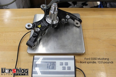

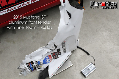

We have weighed a bunch of bits and pieces as they came off the car, like the full weight 84 pound doors with glass. The stock power cloth seats are 50 pounds each, things like that. We will show all sorts of weights as parts get removed or added to this car.

I asked Evan to use our strut tower cutting fixture and open up the tiny tower holes to a 3.0" opening. We used a 2-3/4" hole saw on the 2018 GT but this 3" is as far as you can go and still keep the entire vertical "wall" and the curved portion of the factory tower. Some of our customers have already tested this size opening without issue.
Time for the good stuff! The MCS Remote Double "RR2" model coilovers went from our 2018 GT straight to the 2015 chassis, as did the Powerbrake front brake kit.

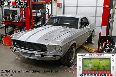

I came in last Saturday and scaled the car with the parts shown above. Its missing 70 pounds of crank/rods/pistons, the radiator, battery, front bumper beam (we will make a tubular one) and bumper cover, left side door, and two seats. We also don't have a fuel tank, driveshaft, clutch, or rear axles in the car. But the rest is pretty much there. The LS is no lighter than the Coyote, as they are nearly identical in weight. But 2327 pounds? I was more than happy to see a number that low.
This is less than the 2349 pounds the car weighed when it rolled in - when it had no motor or trans, no front brakes, and skinny 8" wheels. Jason and I added up about 400 pounds of parts that needs to go back into this to be a running/driving track car. Maybe 500 if we are super conservative. That's still less than 3000 pounds, so we are hopeful!

REPLACE FRONT FRAME STUB
As you know from my previous posts, this 2015 GT chassis was a salvage car put together by The Parts Farm with a bunch of leftover parts, and it had a busted up front end. The damage was isolated mainly to the left front frame stub but the bumper beam was pretty trashed. The upper radiator support was hammered (which is a plastic composite piece we never planned to re-use) and the leading edge of the front lower subframe (the left lower radiator mount) was pretty bent up. We initially just cut both lower radiator mount structures off the subframe, but have since replaced the whole subframe (see section below).
When the car arrived in late August Brad removed the mangled front bumper beam. That deformation had tweaked the mounting plate of the right front frame stub (which itself looked straight). Again, we had taken the car to our friends at Heritage and they measured everything with tram gauges - the frame rails were both straight behind the bent up section on the left front, and we checked the tweaked subframe and all of the critical sections were in spec.
We didn't plan to just replace the OEM bumper beam but it sure would be handy to have one to line up the new frame stub. More on that later. We plann to build a tubular bumper beam like we did on this S197, shown above right. This will let us push the bumper farther forward as well as make the beam wider, for more protection of expensive bits like headlights and such in a light front hit. These S550 front headlights cost $1100/each new, and bring $450-600/each used! It is worth protecting those from a light impact with a wider bumper beam.
After two months of seeing this bent left front frame stub, I finally found a good "front horn" cut from a S550 Mustang, and it was time to replace this front section of our car's frame. There are accordion sections designed into the steel front frame stubs that are made to deform in a crash. This helps isolate the damage in some impacts to just the front few inches of the frame, and it is relatively easy to cut off that and weld something back on. Ford wants you to replace the whole frame in a crash, but insurance / repair jobs typically just replace the front stub with a horn - there were lots of these for sale on eBay. I marked where I wanted the cut with blue tape, just behind the damage, so only about 6" of the frame needed to be replaced. The $120 cut frame horn I bought was about 12" long, so we had lots of room to work with if I "missed the cut" on the first try.
I came into the shop early one morning and started to carefully cut the frame horn with a SawsAll and a sharp, new bi-metal blade. I went slow but this did not go smoothly - the SawsAll was not the right tool for the job, and the cut was not square with my tape marks. When the crew showed up I talked with Evan and we marked a new cut, about an inch further back, and he got to work. There's a reason I hire real fabricators, heh!
He marked both the horn on the car and lined up the same spot on the replacement frame stub, then cut them with this long die grinder with a 90 deg head and a 3" cut off wheel. He cut the stub a bit short then "snuck up on the cut" using the 12" sanding table. Sometimes you have to slow down and use the right technique to do the job right.
This pic above shows the alignment of the car's frame and the replacement frame horn, after Evan had cut both pieces and setup these sheet-metal clamps to hold it in place. These are handy when butt welding two thin pieces of steel together. The placement of the cut was behind the last dimple in the frame, with a round hole in the frame as the guide.
Evan then used the MIG welder and loaded with .023" ER70S wire and stitched along the cut. After the weld was completed he sanded it smooth using a tiny air powered belt sander - I missed that step in the pictures. All of this was done in about 90 minutes, so it went quickly.
After he was done sanding he hit the bare steel with self-etching primer and then - damned if I could see the weld. It was completely hidden. I was going to have him "plate" the seam but when he hung himself off the end of the frame and jumped up and down, it was solid.
I know this might seem like a lot of pictures for what some would consider a simple repair, but this bent frame stub really bugged me. I had to walk by this car every day and see that janky bent piece - and now its perfect. Evan's repair work here really impressed me, and is still a bit baffling how quickly he got this done. Amazing work!

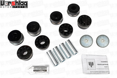

While it was out of the chassis, the 8 rubber subframe and differential mount bushings were inspected. I'm not one to recommend these bushing changes for casual HPDE use, as this is a REAL chore of a job. On this subframe with the age and neglect it has seen, it made more sense to change them. The 5 year old rubber bushings were crusty looking, but again - I don't think this will make a "lap time drop" on these relatively new S550 chassis. This is not something that will likely even "feel better" much less make the car faster - more likely it will add Noise-Vibration-Harshness (NVH), but it will remove some "void" (air) from these mounting points. And no, we won't be adding solid metal or Delrin bushings at these spots on Phase 1. Maybe... maybe in Phase 2.
We ordered the Whiteline rear polyurethane bushings kits for both the the differential mounts (above) and the subframe mounts (shown below). These look very well made and when orientation of the bushing matters, it is clearly marked in raised letters cast into the bushing. The S550 differential bushing kit comes with new hardware, sleeves and washers as shown.
The S550 subframe mount bushings are reinforced at the mounting surfaces with steel rings and also include internal steel sleeves and washers. Now it was time to get to work removing the old bushings. THAT was the chore - removal - but installing the new bits takes only a few minutes. I made a new photo gallery showing the steps we took to get the stock bushings out of the rear subframe, and long story short: it was a a rough job.
Obviously we need the entire subframe assembly out of the chassis, after which the subframe was essentially stripped to the basic steel tubular weldment. That means the control arms, shocks, uprights, diff housing and axles all came off. Maybe you don't need to take it down this far, but it gave us a LOT more access to get to the 8 bushings that needed to be pressed out.
One extra thing we had working against us was the condition of the subframe - it had obviously been sitting in the mud for a while before it was slapped into this 2015 GT chassis. It wasn't even a subframe that came in a GT - as it had the SOLID rear brake rotors and tiniest axles (either a V6 or Ecoboost car), along with an aluminum housing super 8.8" housing (the iron housing is used in manual trans GTs and all GT350/R models). No matter, we were replacing EVERYTHING except the the big cast aluminum control arms. The steel bushings "shells" were rusted into the subframe probably far worse than normal for the age of this part, thanks to the extra harsh environmental exposure.
I've read the horror stories about S550 subframe bushing removal, so we "got ahead" of this by making some custom tooling - hopefully to speed things up. Myles gave me some specs, I went and bought some 4" OD steel tubing shown above, then he made some bits on the CNC plasma table to make this "receiving cup" and some pressing blanks for the other side of these differential bushings.
The steel tubing assembly makes a "cup" to push the diff mount bushings into, while supporting the steel subframe around the hole. The round blank pushes the bushing from the opposite side, and a threaded shaft draws them together. Honestly this should have been easier - the damn rusty bushing shells didn't help us at all.
This was a 2 man operation that gobbled up too many hours - way longer than we expected. We have a lot of specialty tools to do this type of work and we have done it on many other cars, but the S550 bushing removal was the worst one we've tackled in ages. The rusty bushing shells were shot with penetrant and the threaded portion of the tool was tapped with a hammer between impact driving sessions, which helped them pop out of their rusty holes. A car this new should not be this difficult.

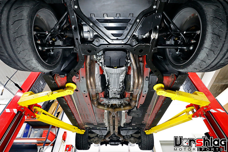

PRODUCTION LS SWAP LONG TUBE HEADERS
Now this might seem to be done out of order, as normally when we are doing an LS swap on a new chassis we make the motor mounts first, then trans crossmember, then the headers - but this time we had reasons to do everything in reverse order.
It comes down to the immense room underhood of this S550 chassis. The LS engine is so little compared to the Coyote this engine bay was designed for that we could take some liberties with engine placement to potentially shorten header development time. When headers typically take 9-12 months to go from prototype to production, I was looking to save time on this step!
And that we did. Sending several measurements to our production header manufacturer, they were able to make something for us that fit on just the 2nd try.Huge time savings, and this is a 1-7/8" primary, proper full length header with 321 stainless bends.
These pictures show our header design that fits this LS550 swap and uses the same design parameters (maximum ground clearance, 1-7/8" primaries, 3" collectors) - it was just easier to make this happen when we put a tiny LS in this giant car. Packaging is one of the many benefits of the LS V8 engine design over any DOHC V8 design.

FRONT SUBFRAME REPLACEMENT
The front subframe was bent in two ways on the car we bought, as I have outlined before. But the critical points measured out OK, so this was going to be ignored to save time and money for other parts of the build. Then a free OEM S550 front subframe and bumper beam popped up on a local S550 Mustang FB group... well I could not ignore that price!
I managed to go pick up these parts last week, and to my surprise, it was all in perfect shape - just like he said. Big thanks to James Mowdy for the hookup on these parts! Major peace of mind knowing this bent unit will be out of our car.
After we unloaded this 58.2 pound stock subframe, Brad soaked it in WD40, which loosened up any residual grease and grime. After an hour of soak the muck was wiped off, then it looked as good as new. Not a ding or scratch on it, which is amazing since this is the lowest part of the chassis.
Yes there are lighter tubular aftermarket S550 subframes versions out there, but those are more suited for drag racing than a road race car. Most of the suspension and braking loads pass through this welded assembly, which also holds the engine, steering rack, and swaybar and their loading. When it is released we will check out the tubular front BMR road race version and see if it makes sense for Phase 2. Their drag race version drops 30 pounds but I wouldn't turn a corner with that thing on a bet.
Once the "new" subframe checked out Brad dropped out the old and busted unit. The SPL front lower control arms were unbolted, the steering shaft was disconnected from the EPAS rack, and the 8 subframe bolts were removed. Some of these bolts were replaced and the holes in the chassis were cleaned up with a thread chaser.
continued below
Vorshlag-Fair
Official Site Vendor
Nov 12, 2010
1,592
116
Dallas, TX
continued from above
Once the old subframe was removed the right front frame stub "relaxed" a fraction of a fraction of an inch, so there was still some stress being held in place from the accident that totaled this car. With this subframe sitting on the shop floor, the EPAS steering rack was removed and swapped over to the new subframe. Man I'm so glad this part showed up because I was reluctant to spend $900 on a new one when a good, used OEM unit like this would do. Just needed some patience and good luck.
Got a few shots of the underside of the engine bay with the subframe out of the way. The LS engine is hung from the engine bay brace and the trans is bolted into the crossmember we built.
We weighed the electric power assist "EPAS" rack while it was out of the old subframe, then swapped it over to the "new" one. Everything lined up perfectly.
The subframe was reinstalled and everything was torqued to spec with the new hardware. The bumper beam was then bolted to the front frame stubs, which lined up perfectly. This "correct" OEM subframe will now allow us to use the lower radiator mount bushings in the front subframe extensions (that we had to cut off the old, bent unit), which should work great with a rolled custom radiator install. I will show the radiator install in a future post.
