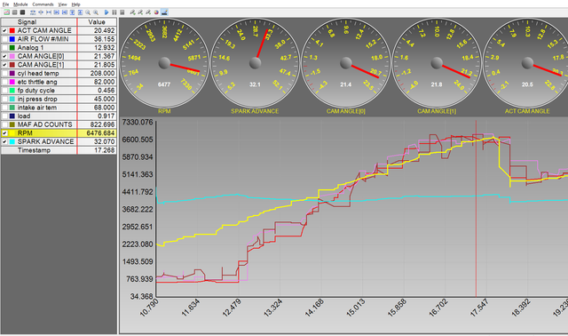

  15. fdjizm
    fdjizm Drag Queen
    19,236
    223
    Definitely lost some torque going to hot rod cams, I know I had to launch higher with them.
    But the tune has to be spot on, you should gain about 30hp with the hot rods cams if they use the ford specs in the tune that dino posted above.
    You can verify this in a log with the ACT CAM ANGLE pid which average both cams or see each individual with CAM ANGLE[0] and CAM ANGLE[1]
    Should look something like this (the numbers never match perfectly)
    [​IMG]
    I've gotten a tune from a reputable place and they left the stock cam timing with the hot rod cams and it made shit for power, till I finally logged and saw what was going on.
    The car ran "fine" otherwise.
