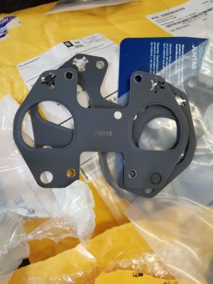

Ford OEM gaskets.
I ordered the Mahle gaskets from rockauto. they are supposed to be here today so i guess i'll wait instead of trying to reuse the stock gaskets. I believe mahle makes the oem gaskets or they bought the company that did because they look exactly the same.
mahle gaskets look just like OEM. you really have to jack the motor way up to get these in there! I had to tighten my motor mount bolts with a pair of vise grips. Luckily I left my torque limiters installed and just wound them out to raise it and back down to lower so the motor didnt move much so the motor mount bolts dropped right in.
