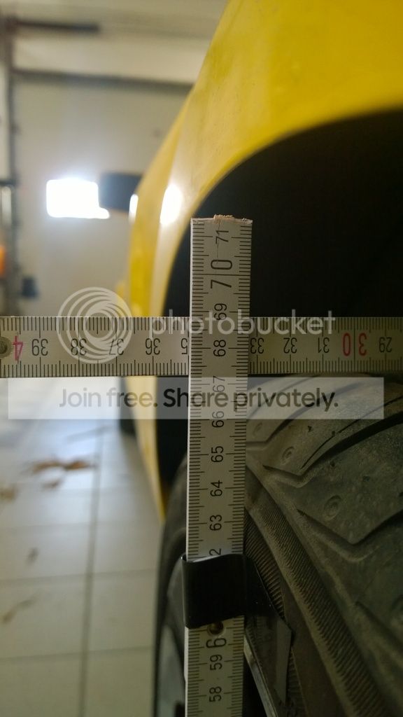

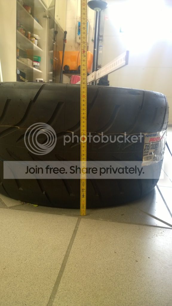

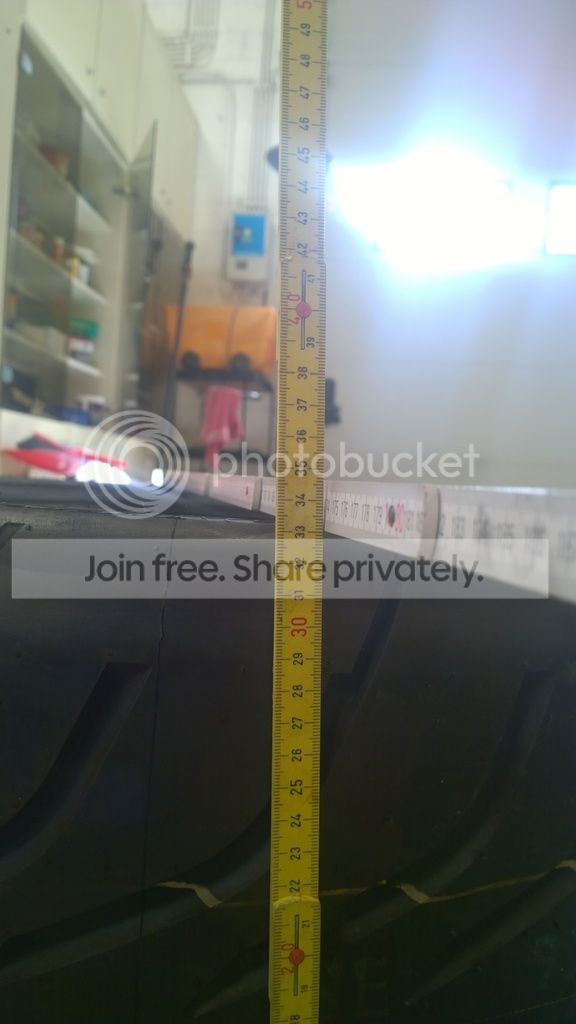

Today they were delivered and when I measured them they turned out to be 330 instead of 317! And now I'm afraid that they won't fit :(
The rims aren't made yet so we can still adjust the offset. Normally we would have went with a 65 offset.
When I measured the car there was 333mm room before hitting the side.

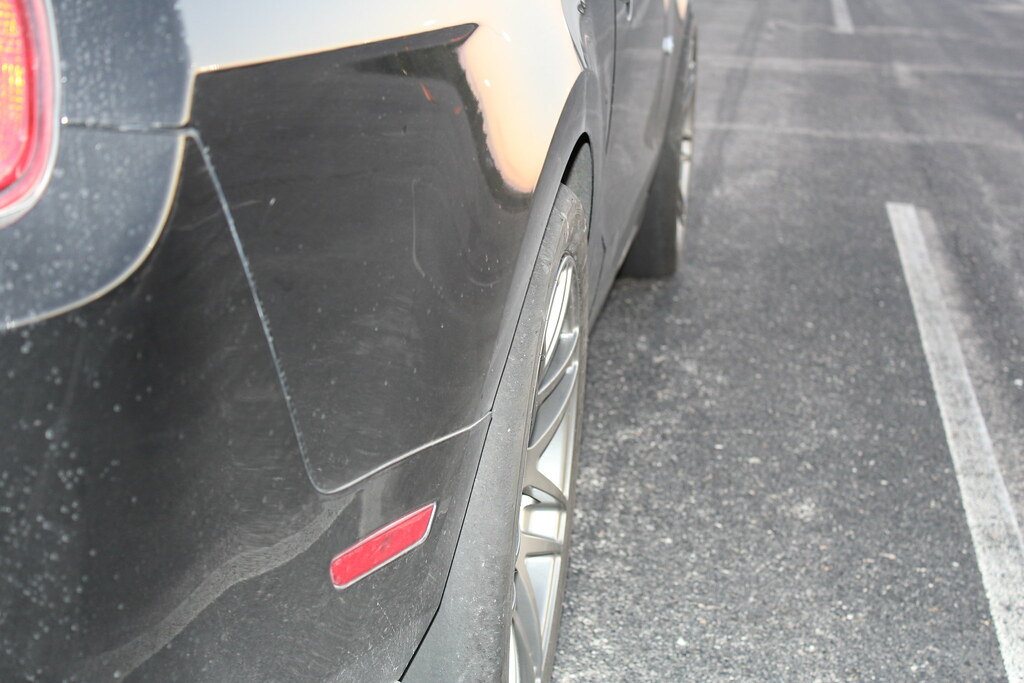

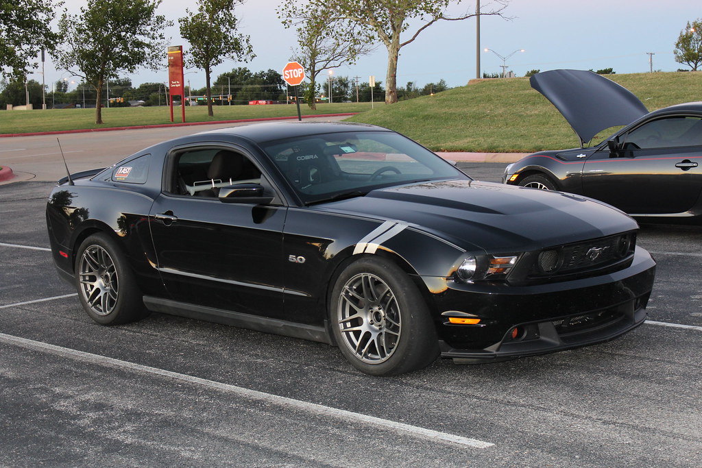

Yep I ran 315's on the front and rear with stock fenders. Those are wide, even for 315's, but 315 also refers to section width, and it may be different depending on the company.
With the correct offset on an 11" wheel- the 315 can tuck inside the fenders-
These were the wheels I ran-
http://www.vorshlag.com/product_info.php?cPath=141_142_268&products_id=624
And I ran variety of tires- Hoosier A6's, Kumho V710's, and BFG Rivals, all in 315 or 295.
And I made this video on mods you need to fit 315's on the front- I apologize for the bad camera and light :/
Also- the use of a Watt's link in the rear can help a lot with rub on the rear.

Got a reply from paul and he said:
330MM tires will never fit without modification to both the suspension and fenders. The amount of medication will depend on the offset and width of the wheel you are building.
And since I don't plan on changing the suspension and bending the fenders I must go with those 305's ...

The tires wont really be 330's when mounted. What is the distance between the outsides of the tire beads where they will touch the wheels? Its probably wider than the actual wheel width will be. So the sidewalls will pull in when mounted.
I had 313/35-20 BFG Rivals on 20x10s with 45mm offset and they just barely rubbed. 50mm offset wheels would have cleared with plenty of room on the back side.
The Toyos are not over-sized. I bet the actual mounted width is the same as the Rivals or most other 315s. Nittos are always on the small side.
As several others have said, they will fit.

Racer47 is 100% right.
Philip - I don't know if it is a language barrier going on here or what but your tires are the normal 315mm Toyo R888 that a whole lot of people run on the backs of their Mustangs. The fact that an un-mounted, un-aired tire might measure slightly bigger than the stated width is not surprising at all. The 315 does not refer to the ACTUAL width, only the tread width, and manufacturers are free to make the tread as wide or narrow as they deem fit and still call it a 315. My 305 Michelins measure far wider than most 315 and fit fine.
I would recommend that you tell Paul that you plan on using the 315mm R888 and see what size/offset he recommends. A 20x11 with a 53 or 55mm offset is probably what he will recommend and I doubt that any modifications will need to be made at all.
There are people running big fat 325mm Michelins and even bigger with few, if any, problems.

By my measurements a 315 tire on an 11" wide wheel should have a 60 mm offset to set the tire just inside the rear fender.
