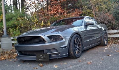

I'm running AM 18x10 AMR wheels all around on my '13, with front 285/40/18s and rear 305/40/18s.
I think they're 42mm offset, and I'm running a small spacer in the front, about 4-5mm thick.

The 18x10 FR500 wheels are a deep-dish design, they won't fit on the front of a Brembo car.
They also probably won't fit on the front of a regular-brake '05-'14 due to caliper interference.
The AMR's fit because they're a much more flat-face design, so the spokes clear.
