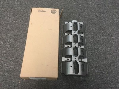

It looks the same as the Ford Performance BR3Z-6710-B combination oil pan gasket/windage tray that came as standard in the 13-14 GT500. It'll also fit on the 4.6 3V engine but you can buy it for much less from a Ford stealership.
Note that you'd also need the 07-14 GT500 oil pump pick up tube (Ford part no. 7R3Z6622AA) so it would also be a good opportunity to upgrade to a 13-14 GT500 oil pump (Ford part no. DR3Z6600A). It's a high pressure pump with a steel backplate that won't flex at sustained high rpm unlike the aluminium one that came on the original 4.6 3V oil pump. Indeed the GT500 pump is now a stock replacement at the Ford stealership.
Finally you could also add a 13-14 GT500 8.5 quart oil pan (Ford part no. DR3Z-6675-A) with only minor clearansing of the GT500 windage tray required. Perfect if you need the extra oil capacity for a forced induction application or racing in a high revving NA application.

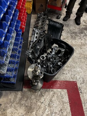

If you look on the left hand side of the bin, you’ll see the tray sticking out from under the pistons. This is from last spring when I had the engine rebuilt 434A247C-643C-488A-B5F1-7D0F95C9303B.jpeg
