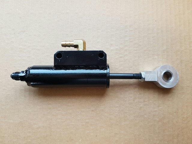

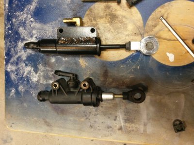

I mentioned the '13 GT500 master cylinder upgrade I've read about on this forum or another to my speed shop, asking if the extra throw would help make sure the clutch was fully disengaging. And they said check out this one instead:
RJM Performance Stage 2:
http://www.rjmperformance.com/05-14-mustang-gtgt500.html
It's the same idea behind putting the '13 GT500 in the GT, but this one's adjustable. The guy has a good thread over on SVTPerformance
https://www.svtperformance.com/forums/threads/project-large-bore-master-cylinder.1130794/
Anyone use it? or at least heard of it? It's a lot more expensive than the '13 MC, but still a lot cheaper than killing my synchros. And Tremec won't cover it under warranty if it's a clutch problem.
