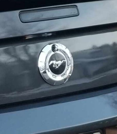

There were some guys on TheMustangSource years ago that mounted the camera in the trunk keyhole (obviously had to do some modifications for the trunk release). It looked pretty stock TBH.
Otherwise I'm in the same boat as you. I've thought about mounting on the spoiler and routing wiring through the mounting holes in the deck lid but that would be pretty tough to drill out the right parts of the spoiler

That would be me. Car is a 06 GT. Wasn't that difficult. Just needed to remove the lock and glue in the camera so water doesn't get in. Then run the wires.

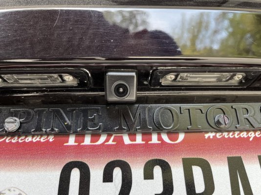

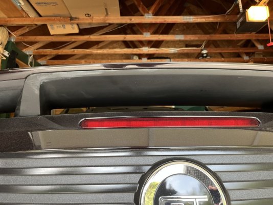

I like what they did with my after-market back up camera install. Mustang had come out with two different spoilers, one to accommodate a backup camera. Anyway, I wanted the backup camera and wasn't crazy about drilling holes in the trunk. The company I went to did drill a hole through the trunk but underneath where the lights for the license plate is located. It is not located on the plate frame. Does a great job.
