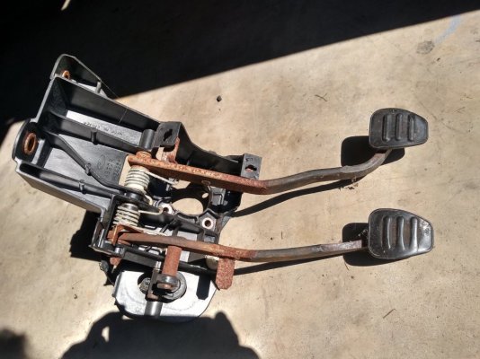

Just a wee side question, does anybody know if the Tr3650 box from the 4.6 2 valve fits the 4.6 3 valve?
I'm thinking of doing a manual box swap now that ive stripped the car.

The TR3650 from the '01-'04 4.6 2V models doesn't have provision for a hydraulic slave cylinder like the tranny from the '05-'10 GT because those earlier models came with a cable operated clutch. If you can also source the clutch assembly, clutch pedal, and clutch cable from a 2V model, you can make it work. You'll also need a flywheel with a 6-bolt flange, and you'll need to check the length of your existing automatic driveshaft to ensure it's also correct for a TR3650.
Note that the earlier TR3650 came with a taller 0.62:1 5th gear ratio compared to the 0.68:1 ratio 5th of the '05-'10. The other gear ratios are the same.
Finally, you'll need to have your automatic ECU reflashed to disable the transmission shift points.

Thanks for the info Dino. I was counting on having to get a manual shaft so it would be a bonus if the auto shaft fitted. ECU needs reflashed with a copy of a manual map? If I can source the flywheel, pedal box etc I might go down that route. All depends on the TR3650 box I'm watching at the minute and if I land it at the right money.
