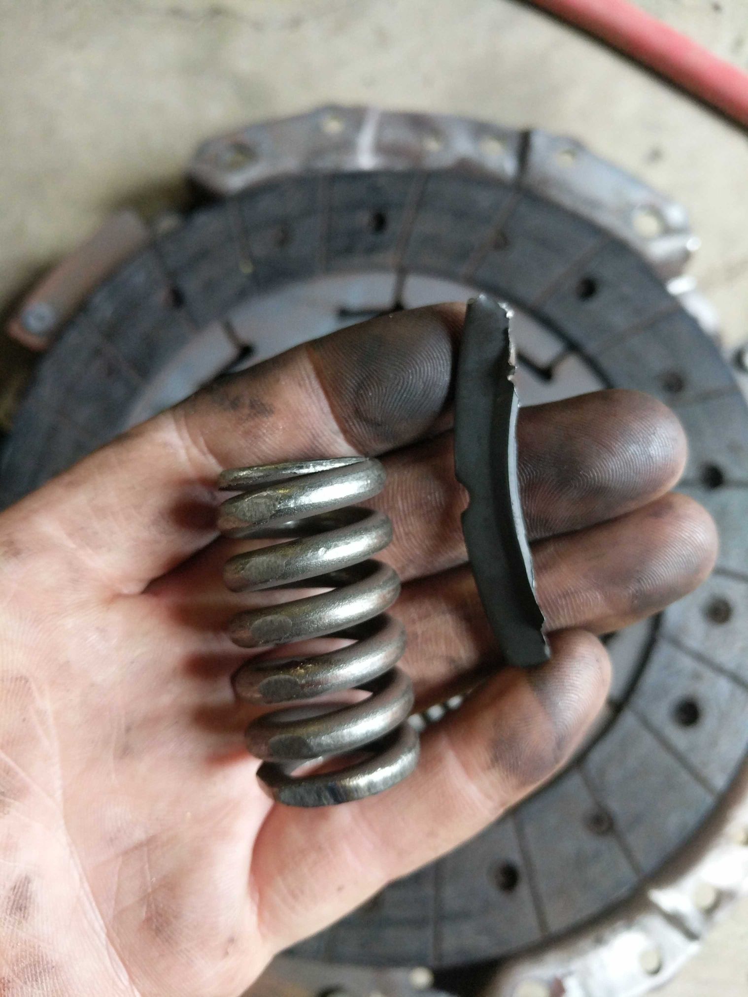

Springs in the clutch are broken. Dealership says they replaced the clutch when I bought the car which was 7 months ago.

Not real happy with Kia of Muncie. There was also 3 bell housing bolts GONE.

I bet that disc was installed backwards and they tried to bolt it down, noticed the error and flipped it. I bet it was cracked the entire time you've had the car.
