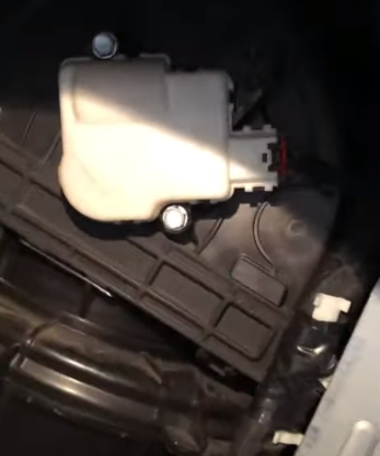

Now that the weather has chilled here in upstate ny im getting the dreaded blend door drum roll upon entering the car... Have to pull some panels and diagnose which is the offender... Joining the masses that have resolved this problem... Oh yeah, had my engine bay detailed last week. Had won a gift certificate at a car show in july with my 63 comet. Finally came in handy for my 09. Bay wasimg_5_1700333343156_kindlephoto-425777392.jpg disgusting... Now looks great. I know the owner of the shop, good guy...

Depending on which one it is, they are relatively easy to replace. There is one howver that Ford's better idea came into play. It is attached to the back side of the evaporator box. Box needs to be removed to replace.

I like to try to put a hand on them when turning the key on. Have someone turn the key on if needed. You can feel the broken gears grinding when the key is turned on :) .
And yeah, they're a pita. I have another one I need to replace now.
Oh, and avoid the cheapy aftermarket replacements. You'll be redoing the job within a year.

The only blend door actuator that's a PITA to replace is the one behind the gauge cluster. The other three are much easier and 100% agree on only going for Motorcraft replacements. They're inexpensive anyway and you can find them at Rockauto.com

Thanks all, yeah I can hear it on the right side. I've seen a YouTube for it.. Glove box and airbag removal should do it... Is the Dorman unit a good replacement..?? Forgot to mention, although I'm getting the drumming it seems all the vent routing is working correctly...

When I acquired my '07 last year one of the actuators was very bad so I contorted myself, cussed a bunch, and got it replaced.
The other day Wifey said her HVAC wasn't switching over on one side in her Lincoln MKT. I looked up to see where it was, and found out they made it easy. Off the the junkyard to get a replacement.
Drop down the glovebox, and there it is, easy-peasy!
