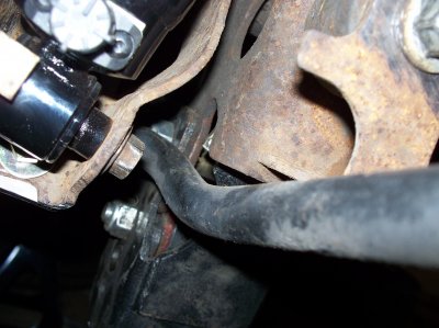

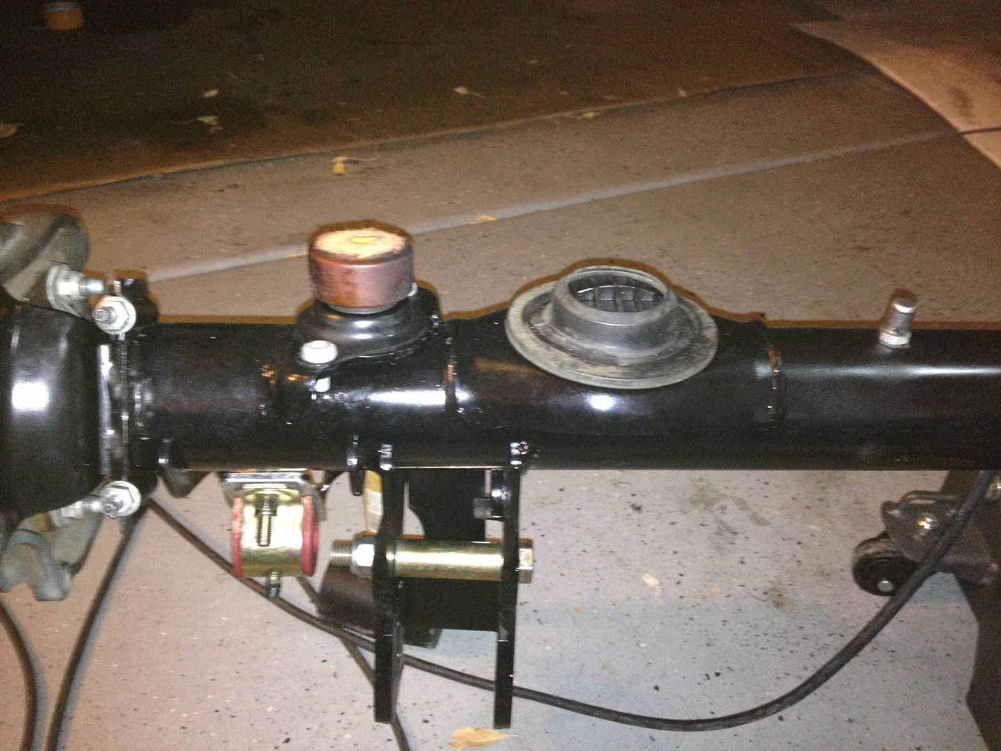

I got the sway bar on yesterday and the sway bar hits the left side lca relocation bracket. I tried moving the sway bar around to get a little more clearance but I did not have any success. The right side is close but does not hit. Can you help?

Is the car on the ground?
Sometimes, people will have clearance issues when the axle housing is at droop, but when the car is on the ground, the issue usually does not occur.
Also, the bar will usually hit the actual OEM (rusted) portion of the LCA Mount, and not the BMR Bracket.
Can you post pics?
Can you post pics?
Thanks!
I will try to get some pictures as soon as I can.
Can you post pics?
Thanks!
I don't have tires on the car. I lifted the car to put weight back onto the rear axle. Yes, when there is weight on the rear axle, the sway hits but at a different point. It hits close to the nut in picture below. It doesn't look like much but it does hit. With the suspension hanging, the sway bar does hit the "rusted" oem portion and not the BMR relocation bracket.
In both pictures below, the weight of the car is on the rear axle (not hanging). If you need to see these pictures with the car on the ground, it will be a few days before I can do that.
Thanks for the help.

Yeah, you "may" have to grind the rusted area slightly.
Keep in mind, it may not hit with the tires on, and the weight on the tires.
Keep me updated.
