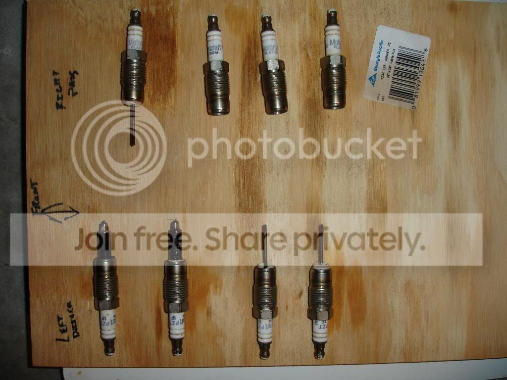

broke all 8 plugs!
NUTCASE
Nov 24, 2009
1,717
15
do you have any idea how much faster it would of been to just pull them like you would any other plug and then used the tool on the ones that break

Man, when I was helping a buddy of mine do his, it took us a LONG time to do them. But, we had a can of PB Blaster and every turn, from 1/8 up to 1/2 depending on how it felt, we would spray a little more on there and let it sit. By the time we would do all eight, we would sit back and watch the game for another 20 minutes, then go around them again. It took all afternoon, but we didn't break a single one and he had right over 72k on the clock and had owned the car since new. But we would turn the plug until we felt a sharp rise in torque and stop immediately. Spray a shot down in there and move on to the next one. There were two plugs that wouldn't turn more than 1/8" each time, which is why it took us so long to get them out.

I guess its just my point of view on working on things like that. if they are comming out, most likely they are being replaced and are therefore garbage anyways. though I will be dillagent in plug removal but if one of those things are gonna break I would rather just use the tool on it than make the job longer and increase my headaches further.
remeber, its the shield breaking off and not an issue with the threads. so its not like your gonna have to do any seriouse head work as a result.
like I said just my way of looking at the job.

I broke all 8 also...

That blows. I broke 5 with 50k miles. Rear ones took close to an hour each and a lot of language.

Wow man sorry to hear that.
Do you think you gave it too much umph when trying to take them out?
Also when they bind you need to stop and soak those babies.
