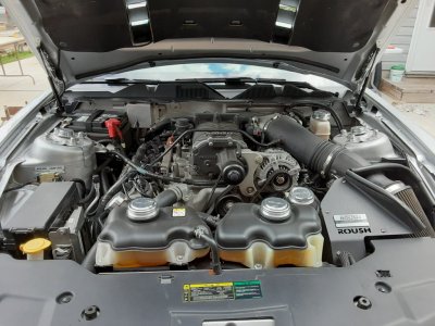

2010 Roush 427R auto with only minor changes, started by using the JDM Engineering 2010 Roush 427 upgrade. https://www.teamjdm.com/roush-2010-427r-teamjdm-upgrade-kit/
2.49 Pulley pushing 8-9 boost on 2010 Roush M90
2011-14 Roush CAI -- Modified to fit but not suggested... also relocated Roush Builders plaque from firewall to the CAI.
Roush off road exhaust, no headers.
JDM Engineering Tune -- 390.73hp 351.40tq on Dynojet. was a cooler day and tires were slipping on my local dyno, had to have a guy sit in the trunk for traction. Never a problem with engine or tune in 30k miles since tune, 30 track days, and several 1/4 mile runs.
