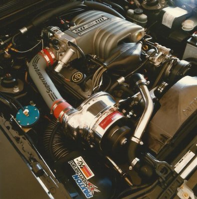

He asked for 3v data.
Hey the Paxton goes back a long way. At first used by Studebaker and then the company stayed in business with Nuclear Subs. Once Ford came up with Fuel Injection, Paxton reissued a kit just for the Mustang. The Paxtons are sort of related to the Studebakers. I know you hate useless information and I am sure you would make Thomas Edison and his friend Henry Ford very proud. Think of it as "What did you have to eat for dinner last week" kind of question and answer.
