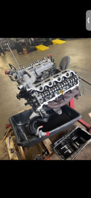

I bought both phasers, the one that’s knocking is passenger side, eventually I will do a second one as well , but as you stated - dropping Procharger off requires some time , so that will be done in near future - oil pump and billet gears are new in there , but other timing components were not changed- and I know that is dumb even on the such low mileage motor considering the cover was off , it is what it is , now I’m paying for it, I’m going to do both phasers, because I can do it myself now, and I know what the issue is. This is a pic when it was swapped into car a year ago with 6000 miles on it
