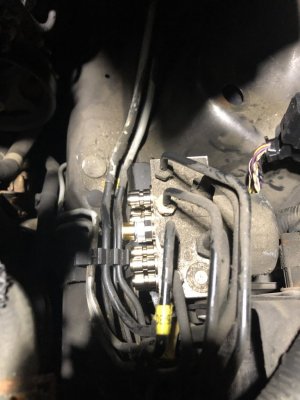

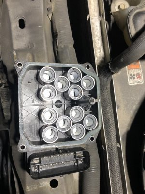

I have not disconnected the brake lines. They are connected to the brake pump.
I have only disconnected the ABS control module.
Brake pump and connected lines on pic 1.
And the removed module on pic 2.
Juice
Aug 24, 2017
5,024
2,149

DieHarder
Nov 9, 2019
1,851
1,072
Not recommended to drive it taken half apart. Given the amount of dirt present wouldn't be surprised that you've already contaminated the contacts. If you don't really know what you're doing do yourself a favor and get a professional to look at it. It may be just end up being something in the left front sensor circuit which on average experiences a lot more abuse compared to the ABS itself.
Plamen
Dec 2, 2020
Thank you for the opinion.
I have not driven it since the module was removed.
It was about to be smart if I cleaned it before removing but...
Can you suggest what should I use to clean the contacts before putting the contacts back?
Just in case some dirt got there...
