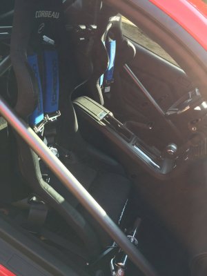

Working with a similar car. Engine all stock other than the roush kit with 82mm. It's got a 2C 245mm and a 3.08 axle, some decent suspension parts, and on a 30x10.5 radial tire.
Best is 1.49, 10.18@138. I really think it should sixty in the 1.3s and it isn't liking that converter much. Plan is to go to one of the stock converters that circle D modifies, and also I have some ideas for the calibration to hopefully get the converter locked sooner. Hopefully those 2 things will get that 9 second slip. Going to change to a 2.73 gear sometime, not sure how that will affect it, but it is really wound tight in 3rd now and I don't want another shift.

Still heavy, a bit over 3500 with driver. It's got a big ice tank in the trunk and a mild steel roll bar from Waston. Only things taking weight off are tube bumpers, dumped exhaust, seats, removed evap, front brakes, tube rad support, wheels/tires.
Mine weighed a little over 3800 with me in it before removing the front swaybar, I'd guess upper 3700 now. Once the shifts are close I should be able to lose about 100 pounds pretty easy by removing seats and adding skinnies.
