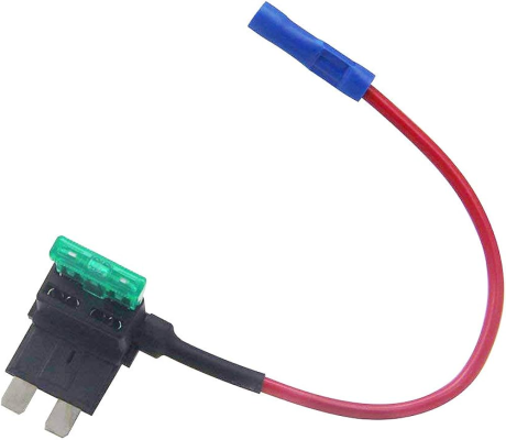

Hello everyone. Just curious, is there an alternative to a third fuse tap in the SJB? I'm looking to provide constant power to the newly installed dash cam but don't seem to have the space. One fuse tap provides switched power to the Aeroforce Interceptor, the other to the dash cam. Need constant power to enable the parking mode feature.

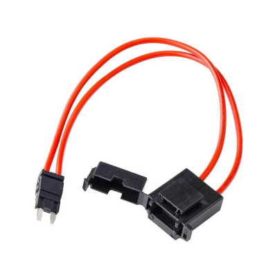

If you don't think you can fit another mini fuse tap in there, you can use a mini fuse extender On one of the +12v circiuts and then a blade fuse tap there.
