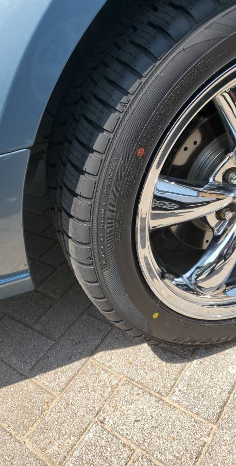

I've got a 4.6 2007 with 73K miles. The past 5,000 miles or so I've been trying to get an issue with my car shaking resolved. So far, I've replaced the rotors and pads all around, replaced the tie rods, got new tires, and replaced front lower control arms with the upgraded GT500s. The handling is more responsive but the car shaking is still there.
Top rated suspension shop in the area couldn't find anything else wrong. One thing I've got to mention is the front tow was off on my front tires wheels today even though the suspension shop did an alignment just on Monday when they did the control arms and tie rods. I don't know if they just didn't do it correctly or if something went off.
Anyways, can y'all give me some pointers for what to look at next? I'd like to actually do some fun mods on this car but not until I can get things smoothed out. Thanks!!

Factory wheels or aftermarket?
Aftermarket from AmericanMuscle
