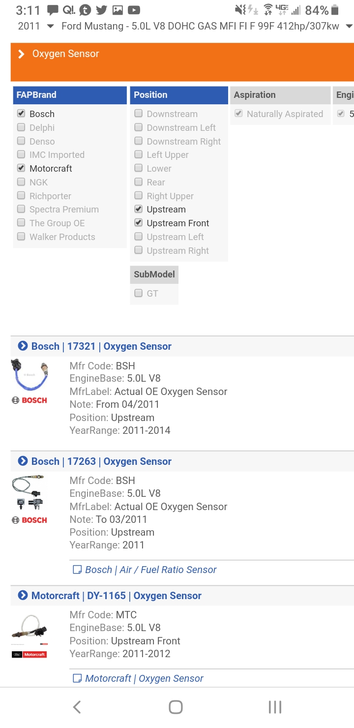

Are the voltage parameters different on lower end sensors? That would make sense to me for it throwing a false code. Are the parameters tighter on NTK and Motorcraft sensors? I found a motorcraft sensor on rock auto that is the right one, but already spent money for the other two sensors and don’t want to spend if it’s another issue. Jgt58?
Jgt58
Jan 1, 2020
295
77
Always if you can go with motorcraft replacement. Let me verify via my parts lookup. I'll screenshot
Jgt58
Jan 1, 2020
295
77
First I want to say I was incorrect. Bosch is the actual or manufacturer. Here your correct part numbers.

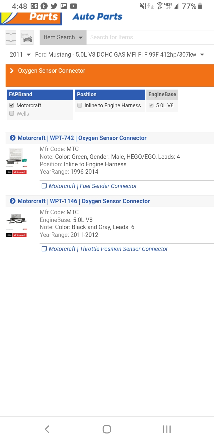

Jgt58
Jan 1, 2020
295
77
Here ya go on the connectors

Jgt58
Jan 1, 2020
295
77
My prediction is that code stays the same and that it's a wiring issue
