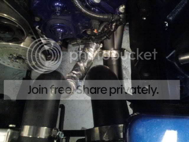

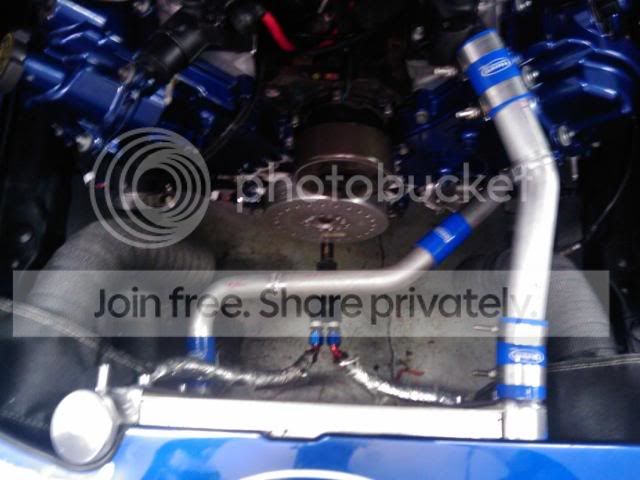

Been a VERY LONG haul and by far the most complicated build I have ever been involved in but barring some random fluke, the Killer will be running at PSCA at Fontana next weekend...:hi:
All that's left now is to see what she will do. Today we knocked out the last little thing that was bothering me and that was the rubber hose lines to and from the rad. Reworked it all with aluminum and I can say there is nothing left for me to do with this car that I can think of...
How it was...
Now...
What I need now is some serious seat time and learn this car cause it is definitely another animal now and I need to 'tame' it. At least, I need to learn how to drive, work the 3 step, dial in the controller, etc, etc. All the stuff that can only be done by making passes but at least I'm FINALLY at the 'making passes' stage...lol We'll see what she does on Friday - should be fun - at least I HOPE so...:beerdrink:
