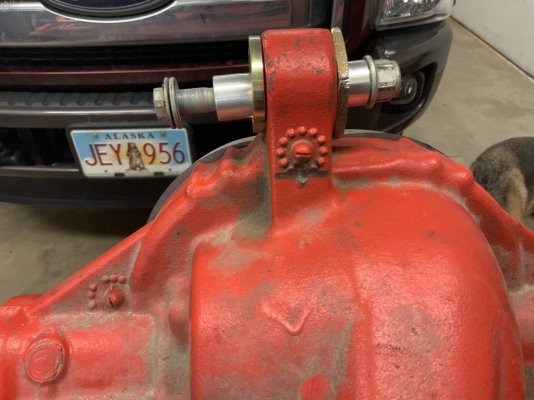

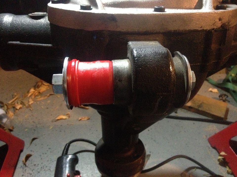

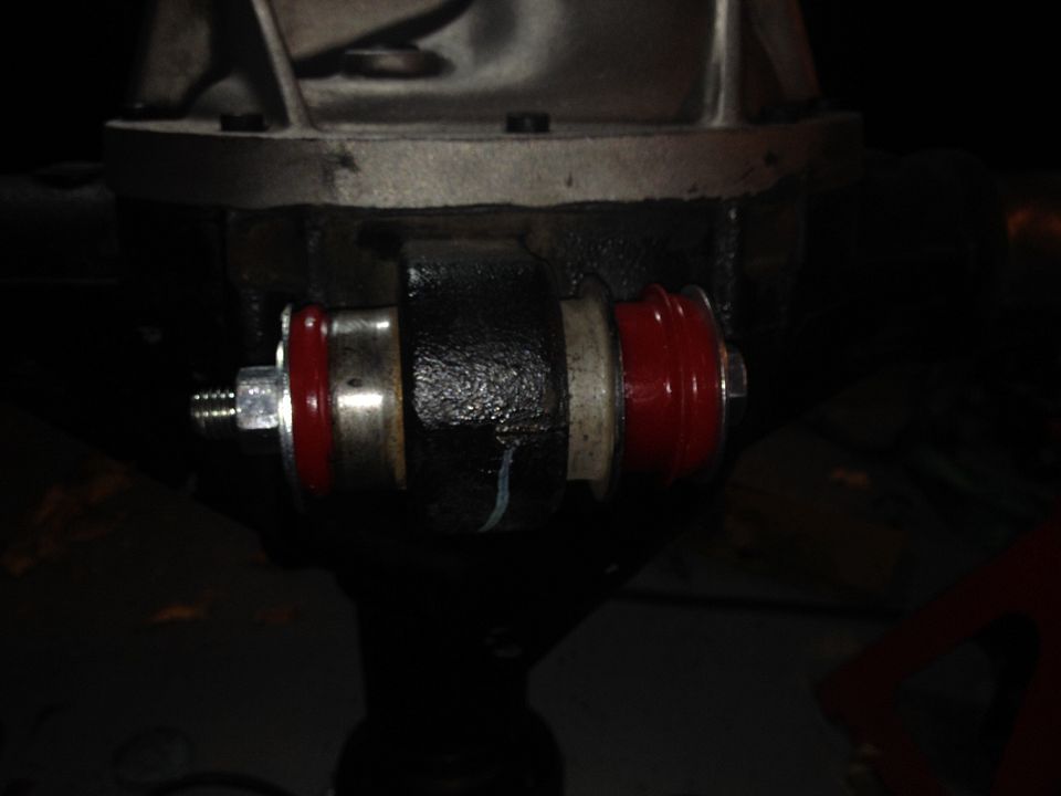

Call BMR. This is the bushing I got from them. It's a 3-piece bushing that slides in pretty easy.
It;s the removal of the stock one that is the PIA on this install. I used a hole saw and then a brass wire brush to get my sleeve ready for the bushing.
And then I made the little tool I used to get the bushing pressed into the sleeve. The bushing only goes in one way, so if it is difficult to get it in there try the other side.
This is the wrong way but it shows the little press tooly thing.
The long bushing piece goes in from the side with the little lip or flare on it, Then it slides right in like a virgin on prom night.
Then I left the little install tool on there to hold it in place until I was ready to hook up the upper arm.

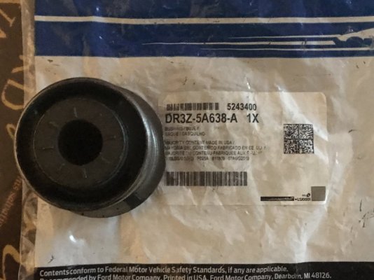

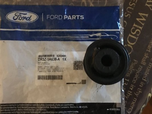

Just helping out here............below is the very 13-14 OEM Ford GT500 8.8" 3-Link rear axle UCA diff bushing I'm assuming is being referred to for consideration............it is made using a MUCH stiffer durometer rubber compound vs a std 05-10 OEM GT\07-09 GT500 UCA diff bushing but still designed to allow full OEM rear 3-Link axle articulation (main reason for posting...........there are 3 different versions\part #'s of this Ford OEM 8.8" 3-Link axle UCA diff bushing.....1 for 05-10 GT\07-09 GT500--std durometer, 1 for 11-14 GT\10-12 GT500--intermediate durometer & this 1 shown below for 13-14 GT500--stiffest\max durometer).
I'm running this very rear UCA diff bushing on my '09 GT's rear 8.8" 3-Link axle...............it is the real deal.
Hope this helps.
Hope this helps.
This is the one I would use if doing this job today. I might also consider using the upper control arm and mount from the 11-12 GT to take advantage of the longer length arm.
