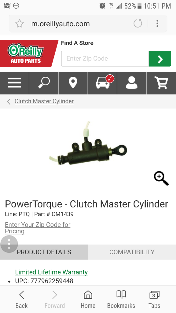

That's the best price I have seen so far thanks. Was looking at the one LMR has but wasn't sure if it was oem or not.
Gh0stRep0rt
Feb 14, 2017
67
I bought this one from O'reilly...
