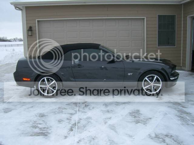

I was wondering if anyone had a pick of their car with the front and rear installed or has anyone even installed the front. I just wonder if it will make the car sit higher in the front due to the fact we have a lighter engine than the CJ.

Here's a side shot of mine... but the fronts are still stock. I am still undecided on whether I will swap the fronts. I may just wait to see how the rears work and then try with both installed.
Along with a comparison with the Roush rears installed

thanks, so the springs in the front are stock and not the roush springs. Looks like you are having some nice Christmas weather.

hell it is almost 70 degrees here and sunny I would kill for some winter weather. thanks again for the pics if you decide to swap the front please post up another pick. I am at the track every weekend so if the front will help with weight transfer even more I would like to do it but not if it makes the front look like I could go offroad.
