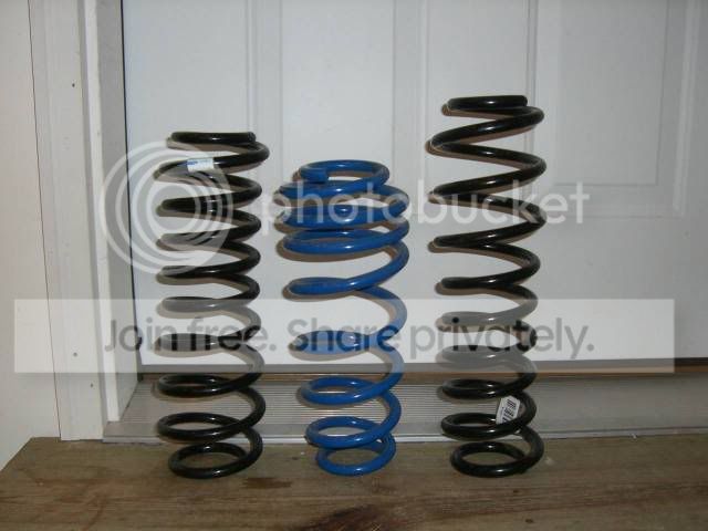

As another reference point, here's a side by side comparison between stockers, CJs, and Roush. I just swapped out the Roush's this morning with the CJs and my new ride height is not that bad looking. Granted, not as low as the Roush's, but still lower than stock. I know it will settle a little once I drive it in the spring, but as of now both sides measure ~28.5 in to the fender lip. Mine might actually sit a bit lower than a coupe given the extra weight of the ragtop. And since I want to run 28in DRs, that should make it look about right along with having a little rake.

Thats a great pic. Thats helpful for all who are interested. Thanks Doogie

It may be stupid but...I assume the spring to the left is the CJ, blue is Roush and the one to the right is stock?
