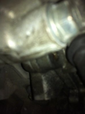

Well I don't think vacuum is a issue any longer. I started tearing down the engine tonight. I am removing front cover just in case when I pull the valve covers and see all hell broke loose I can remove the heads without delay. I did fine a problem maybe a slight vac leak here but if it is leaking air it must be silent. This is on passenger side, right where the ac compressor mounts up. Timing cover meets oil pan

Nick, you don't waste any time, lol.
Best of luck with that. Let me know if I can be of any help.
