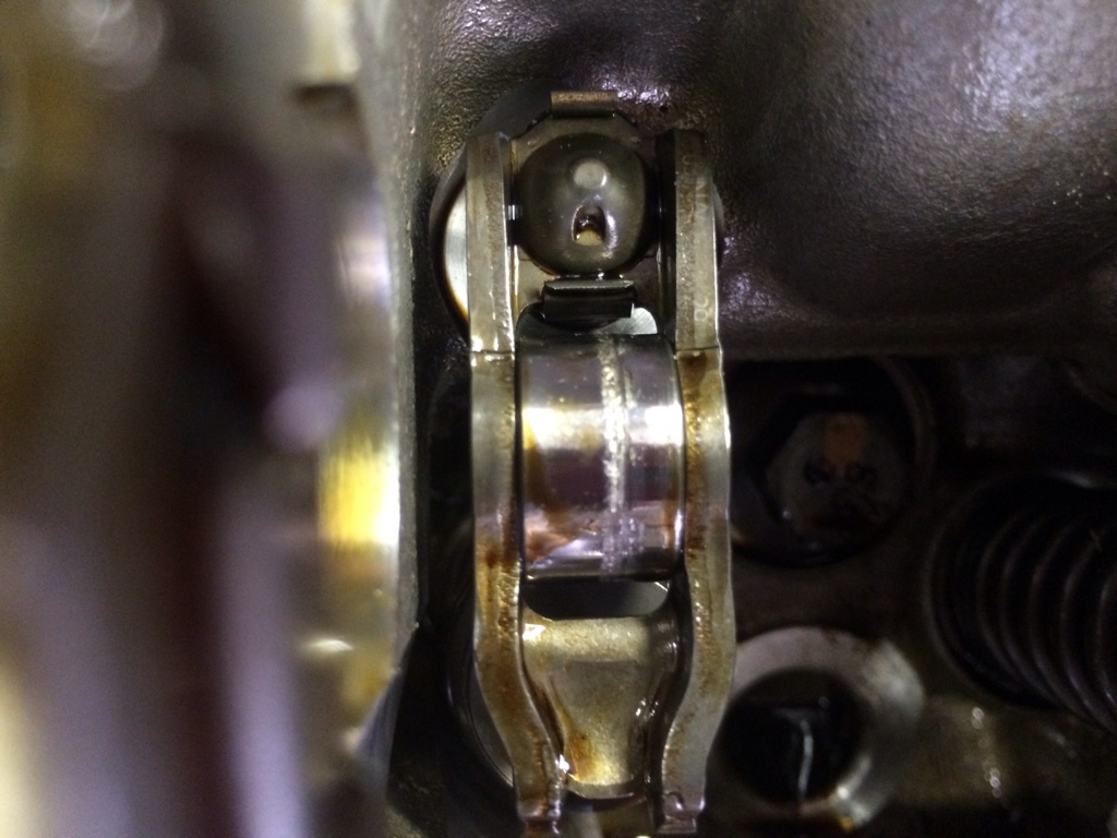

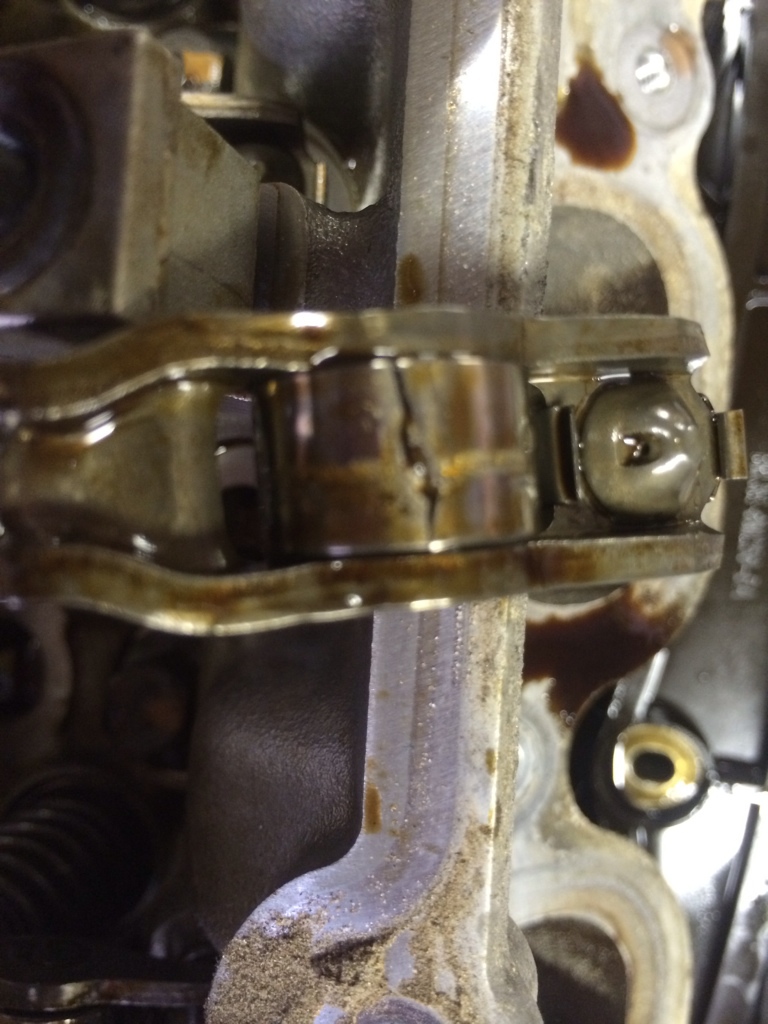

anyone ever seen this before?
I am trying to figure out how a 81K mile automatic stock car would have been able to do this

How does the cam lobe look?
It's got a groove on the top of the love where it pushes the follower down
It looks to be caused from the follower rolling on it.
I would have guessed a major over rev if it was a stick car but it was a auto and was stock intake etc
