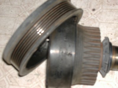

Went to drive the car today and I had no power steering as I was backing out. Popped the hood and the serpentine belt was off and noticed the crankshaft pulley was destroyed! PIC BELOW (Not my pic but same thing happened to my car). Now I need to fix it and wanted to know if you guys have any advice on how to tackle this. I have zero tools at my apartment and will need to either buy them all or just pay someone to do it. I rather try myself but figured I would ask you guys first. Called around and I can get a Dorman Harmonic Balancer for $80 and rent two tools, one to take off the old one and the other to put the new one on. Dealer wants $450 and that’s ridiculous so that’s why I rather try myself

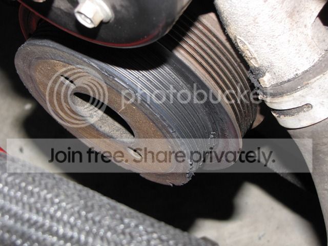

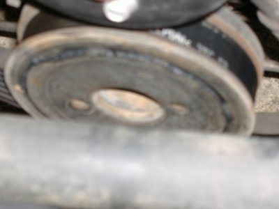

i replaced mine with a oem replacement from the dealer the first time, then i went with the under drive the next time. had to remove the fan and maybe the rad to get the impact gun on that bolt. the puller kit i had, the small bolts werent long enough to reach the threads on the original oem pulley, so i had to come up with some and they are metric. not sure why they designed those darn holes to sit back in so far.
also the throw on the pulley puller runs out. you can come up with the right size spacer but a easy way is to deal with that is just loosen the bolt in the crank about 3/8" and use the head of the bolt. install the puller and start to remove it till you run out of throw or hit the bolt, then back the crank bolt out a little ways more like 3/8" and do it again. might take 3 times and its off. i got the new bolt from the dealer.
the replacement pulleys have a rubber coating on the outside to keep the water off and the small bolt holes are set up better too. on my 05, i could see where water got onto the outer ring and started rusting, then the rubber let loose. i got lucky and limped it home, (putting the a/c on kept a little extra tension on the belt) but the belt edge shredded a little and beat a hole in my hood blanket and ripped up the heat shield on the erg tube. it could have been alot worse.
i knew the time was coming to replace it by the tattered rubber ring, a sure sign between the inner part and the outer ring, but once i noticed it it went really fast. (the wot runs didnt help) with the replacement pulleys you cant see that rubber ring so i dont know about those, and my first replacement didnt fail like the original one

sorry for the horrible pics, but thats all i had. you can see the rubber ring, 3/4" in from the grooved part that looks rough or tattered. it should look smooth. thats a sure sign. when i saw it i thought, na,surely it will last a while. nope about the time i noticed it the belt was squeeling just at start up, and within a week it got worse, then after work one day i started it up and looked while it was squeeling, i could see the outer part of the pulling moving in and out while it was running.
i think this was more of a 05 issue, and the guy at the dealer i talked to said it wasnt just the stangs, it was all the 4.0`s, trucks, cars etc. and they were doing alot of them. so fords was well aware of the faulty parts and it should have been a recall. alot of people paid 5-600.00 to have it replaced at the dealer. shame on you fords :naughty:
