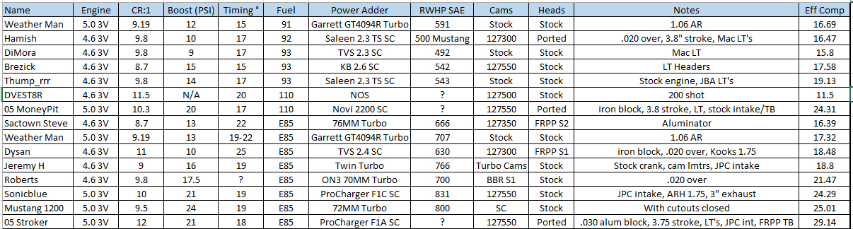

I'm collecting CR / Boost / Timing in this thread: http://www.s197forum.com/forum/showthread.php?t=121142
I built a spreadsheet so I can do analysis and averages.
Results so far:
Looks like most people run an average effective CR of:
17.13 with 93 octane
21.36 with E85
With 11.5:1 CR and 13 PSI of boost, I'd hit an effective CR of 21.67 and be in the ball-park of what other E85 users are doing. I figure that could make RWHP in the high 600 range.
If I stick with 93 Octane I'll probably be in the 540 RWHP range.
I have GT500 pumps and a KB dual BAP with 52 LB injectors. What size injectors will I need to put this on the corn, and can GT500 pumps with a dual BAP handle the load for high 600 RWHP?

I have been doing a little research on compression ratios and I am not sure it makes the most sense to go over 10:1 unless you are on the corn. Here are some compression ratios for OEM supercharged cars:
2013 GT500 - 9.0:1
2009 GTR - 9.0:1
C7 Z06 - 10.0:1 (direct injection)
C6 ZR1 - 9.1:1
2003 Cobra - 8.5:1
I highlighted direct injection since it does allow for better detonation control since it is shot right into the cylinders. I think that is how they can increase compression ratio to 10:1 and be safe. Rule of thumb is that you get 3% for each point increase in compression ratio which about what you can get for 1 psi of boost.
Lets say you are making 600 HP on 10:1 and 14 psi of boost. Moving to 11:1 nets you 618 on same boost, but if you turn down the boost to 13 psi, you are back down to near 600. If you went down to 9 psi, you would be more like 538 HP. In the end, the compression ratio gives you some gain, if you keep the boost the same, but it isn't worth it using pump gas. It is safer to keep the compression ratio lower and add more boost.
