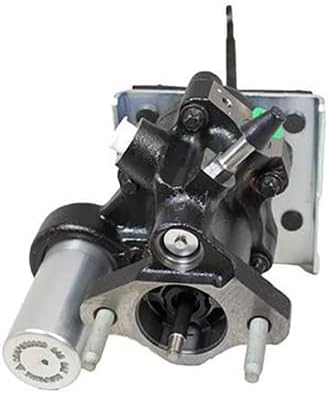

Something to consider. Running a wide duration narrow LSA cam will usually have miserable low end torque. You may also have to use a vacuum pump connected to the break booster.
Thanks for the info. Are you able to provide me with a link? I tried looking that up and all I get is something like a house vacuum

Thumprs don't hurt brake performance
You need a minimum of 18 inches of vacuum, anything below that and your brake booster will not work at 100%. Thumpers will only give you about 12-14 inches of vacuum. your cdar, your choice.
18-inches
MC: Any brake booster in the world requires 18-inches of vacuum to operate at peak efficiency.
RocketcarX
95% of my weight is fuel
Jul 19, 2011
2,738
220
Colorado
I've used those cams in everything from nitrous to serious road course use and they absolutely produce enough vacuum to stop the car in each application.
