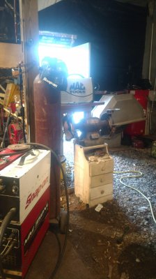

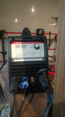

Got my Tig today . I Can get some practice now ..ya

My buddy has that exact same mig welder. It's a nice machine.
Sent from my SAMSUNG-SM-G935A using Tapatalk
Yes it's a power House too much for mild with 45 wire
She is a 350.

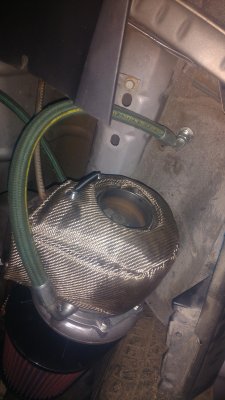

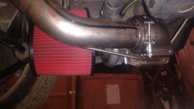

Hey guys got a big ass filter to make us giggle. Biggest thing I can get to fit and I mean big. I have to bevel the inside lip of the filter, so the filter can go back about another 1/4 or so. She sits just on the sway bar link. Might take a half in off the clamping surface on the air filter.

Should cut a hole in the floor and run the intake into the car. Hear every bit of induction noise. Lol

yup, get them chilly iat's to help counteract the boost temps :D

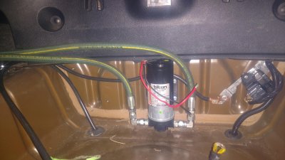

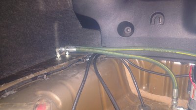

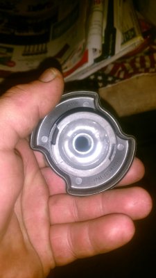

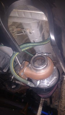

Well got my oil cap modified for the return, modified the air cleaner and a couple other things for fitment. Got my return line up into the trunk with a bulkhead. My Tilton will be in on Monday so I mount up and Fab a box for the Tilton to sit in. And I'll run from my oil cap back to the trunk tonight in preparation for the pump. Not bad for weekend builds I'm happy with my progress I actually got to hear it run through the turbo charger this week...

any reason its going to the oil fill cap rather than a drilled/tapped hole in the sump?
I just want to be able to return to stock with no trace evidence it was ever boosted. No sign that there was any modifications to the car. If I went non intercooled I could easy pull it off . But seeing as how it's just got a power train warranty yet . I guess it dose not matter

Couple more things installed.. just need to tie a few things up on the oil system.

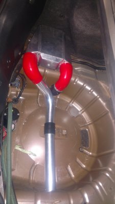

Hey guys..Couple new ones, bin busy then got sick over the weekend.. iv bin doing wiring
