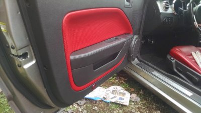

tntacoma21
Nov 2, 2015
knoxville,tn
Well, I repaired my drivers side panel today. The car is an 09 and looks like this is the first time its been done. The passenger side is barely loose in the center. I used Loctite professional 300 series spray adhesive it feels like its really sticking well. It's a little damp today so I took a hairdryer to the panel after I tacked it all up. I'll post up how long the repair lasts, hopefully I can get a few years or at least a couple before I have to redo it or find an alternative.
Sent from my XT1058 using Tapatalk

tntacoma21
Nov 2, 2015
knoxville,tn
Thanks, I used an toothbrush to get the old foam off, I masked off the door and sprayed 2 good coats of adhesive on per the directions on the can. I used a value card to help smooth the insert and tuck the edges in
