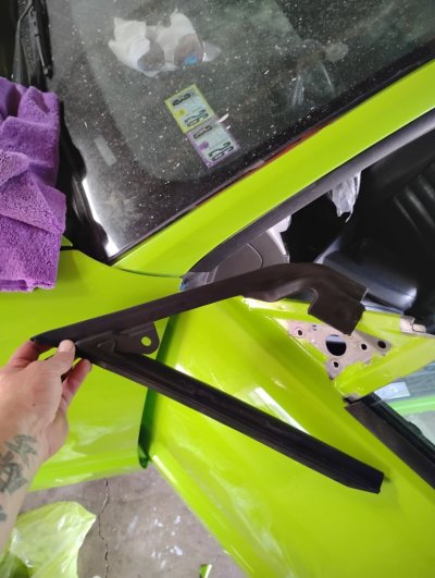

Hey guys .
Just got around to painting my car and wet sanding it and buffing it.
Man let me tell you what a process that was ..
I underestimated time big time on how long it takes lol .
But anywho ...

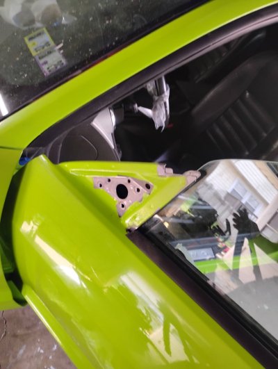

Im putting everything back together and I cannot for the life of me figure out how to put this mirror or door gasket on...
Can anyone help or show pics of their door so I can see how on earth it goes on...
After about an hour I gave up
Rear pic so you can see the color

The straight part is the window guide, the part with the fat end goes towards the front, in between the door and fender. I would roll the window down all the way and guide the straight part down along the window and work it into place. Some soapy water (water with a few drops of dish detergent) will help immensely.
whitmanink
Dec 28, 2020
665
341
denver pa
Ohhhh .. I was looking at it in a different way.. lol duh now it makes sense
After work today I'm gonna go out and
do what you said .
I appreciate the info.
