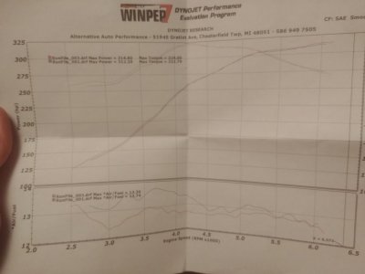

Just looking to get your input on a few things. I recently had my 3v on dyno jet. Sae smoothing 5. Came out to 315/324. this seems a bit low to me considering my mods. IF this is true. And saying i have lowered my weight atleast 100lbs. What should i expect for a 1/4 time.
2005 gt 3v 5spd
K&n cai
62mm throttle body
Equal length shortys
Off road xpipe
Slp loud mouth
Under drive pullies
Hotrod cams
Custom dyno tune 93oct

once again a dyno is a comparison device. What did it make initially and what does it make now with the mods. The difference between the two is your result not the final number. Few dyno's produce similar results. They aren't calibration certified via a department of weights and measures standard. The same applies to a bathroom scale. Step on one and you will weight different than you do on the next one. It's the before and after from the same scales that tell you what your weight loss success has been.
How the car transfers power to the ground without blowing the tires off is what will be one of the two biggest factors in ET. Driver ability will be the other. Slap a pair of 26" quality DR's on the car and go have a good time.

I understand dynos are a tool and all that. I asked for a before and after but never got the before sheet. I was asking for a comparitive not an exact answer. I was looking to see what others were putting down and what they were running with similar setups. No need to rant

Its because there are too many variables to answer your question.
Driver
Track
Conditions
Power of car
Tires
Under great conditions, with a good tire designed only for the track, and everything else working, 12.6-12.9@ 104-108. That is based off of what I've seen others with similar mods run. Again, probably the most important factor is the driver and tire. Having nothing to compare to is just difficult.

I posted all the mods including hp/tq and tires nitto nt555r drag radials. But if the question is too vague still my bad. I thought i had enough info.

Your dyno numbers are similar to mine, but my best run was with some temporary weight reduction (removed front passenger seat, rear seat, spare wheel, trunk contents, and 1/4 tank of gas) and with a DA near sea level. I also hit the 6500rpm rev limiter at the top of 3rd.
I think your times were hurt by the heat.

yea i rode out 3rd at 6500 with my spare tire and all that gone. full interior. the heat definitly sucked. lack of experience was another fault. TBH now that i have this new tune. it feels like i picked up a bit of mid to low tq just a seat of the pants feel. i have to get it back on a dyno to see what happened and where the curve moved. then get back to the track.
what was your best et? mph?
