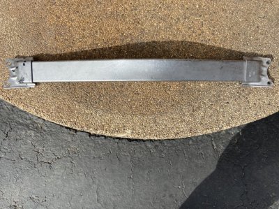

View attachment 71878 View attachment 71879 That one came from CJ Pony. I have a used Boss 302 strut tower brace that I had before. Let me know if you’re interested.
What's the condition of the brace and how much do you want for it?
BTW here is a response for our tech guy on your question.
The intercooler is RTV’d in and near impossible to remove after that. Most people that try to get it out damage the intercooler and the supercharger housing itself. PCV oil on the intercooler core is a normal deal and should not be a concern.
Thank you!!!! That helps a lot. The brace has some discoloring on one end. It is not corrosion. I think I missed rinsing off a degreaser and it stained the finish. Otherwise, it shows 3 years of wear. Can be easily painted.
I got the new one as a present. My family heard me say I wished I had seen this one first. I got it last Xmas. New Boss 302 braces are $200. I’ll take $50 plus actual shipping.

View attachment 71881 View attachment 71880
So this will fit with the Edelbrock Supercharger? What's it made of, steel or aluminum? Can you tell me what shipping would be to 29576?
Is it made of aluminum or steel? Did you have it on your car with the Edelbrock supercharger? Can you see what it would cost to ship to 29576. I am interested! Thanks...
Yes I had it on the car. You can see it in the photo. I’ll check shipping price and get back ASAP.
