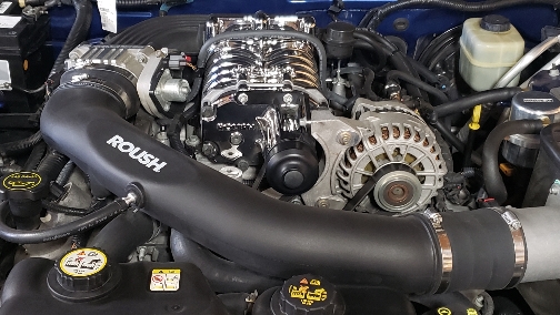

IMG_3138 (1).jpg I did my own install 3 years ago on my 05 with 48K. Since then, Ive added cam, headers, and exhaust. Three months ago, I converted to E85 and raised boost up to 8 pounds. Haven't dyno`ed new setup yet. I had Lito tune the car after a real crappy experience with Brenspeed. What a difference!
Since you are with Edelbrock, you will be the perfect person to answer my question. I called their customer service, but couldn't get a definitive answer.
Does the top of the E-Force unit come off easily so the intercooler can be removed and cleaned? There has been an air filter on it of course, but with the PCV going into the engine after the throttle body, I believe there must be some buildup on it? Can you help?

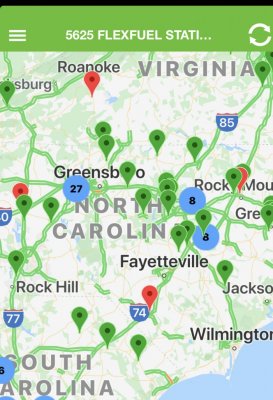

That’s not practical for me at all. There aren’t any stations near me in NC that sells it. I’d have to drive to SC every time I need fuel.
MrAwesome987
Mar 6, 2019
945
302
Upstate SC
If he's in Western NC, then he's right, there are basically no e85 stations around there. I have had mine on e85 and went driving up that way and couldn't find it anywhere.
Laga
Aug 10, 2019
1,132
656
Chicago
Even if the closest station is 10 miles away, it could be highly impractical to run every day. But for track days or even blasting around on the back roads, the returns are worth it. Plus, he all ready has the SCT. It’s just a question of switching tunes.
