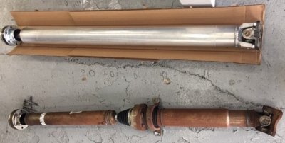

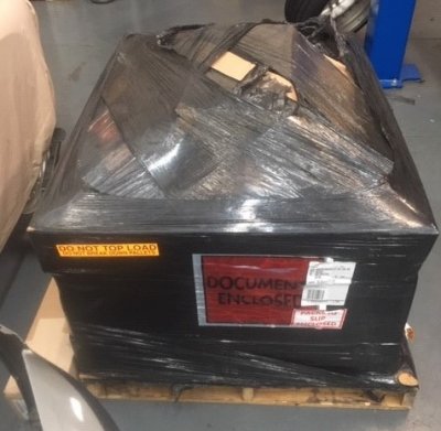

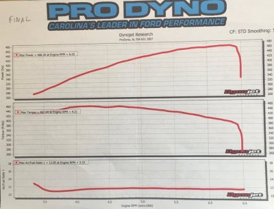

Dyno Final.jpg Car.jpg car on Dyno.jpg drive shaft (2).jpg pallet (2).jpg in the box (2).jpg Mr Brown (2).jpg OK guys sorry for the delay! Dan and his team at Pro Dyno are really excellent. First pull we hit 500 RWHP and over 475 ft-lbs, so he pulled back on the tune a bit to be safe on the stock non-forged internals. Ok by me! BTW only 20k on the engine.
We landed at 468 HP and 457 ft lbs at the wheels. The car has Comp Stage 1 NSR cams and stock manifolds with Manga Flow x pipe and cat back exhaust, it sounded awesome up around 120 mph! I also was able to get a one piece drive shaft from the drive shaft shop, really a nice piece.
Originally I had a set of M/T ET Street SS tires but with the rain I opted not to use them. The M/T Street Comps hooked up extremely well. In fact I used my 255/45R 18 in the rear and they were great. I have since mounted a set of 275/40R 18 Street Comps.
I ran into a bt of trouble with the GT 500 fuel pump that I'll be looking into this weekend.
Overall this was a a great experience. I am not sure I will leave the 4.10 gears in since it shifts much too quickly through the gears. Thinking maybe 3.55, it's got so much power and the torque curve is so flat!

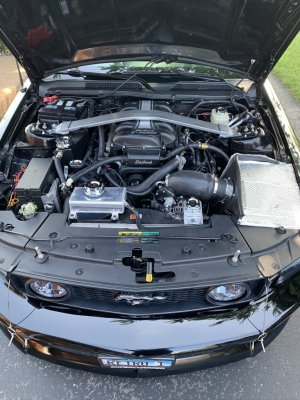

View attachment 71745 I did my own install 3 years ago on my 05 with 48K. Since then, Ive added cam, headers, and exhaust. Three months ago, I converted to E85 and raised boost up to 8 pounds. Haven't dyno`ed new setup yet. I had Lito tune the car after a real crappy experience with Brenspeed. What a difference!
Since you are with Edelbrock, you will be the perfect person to answer my question. I called their customer service, but couldn't get a definitive answer.
Does the top of the E-Force unit come off easily so the intercooler can be removed and cleaned? There has been an air filter on it of course, but with the PCV going into the engine after the throttle body, I believe there must be some buildup on it? Can you help?

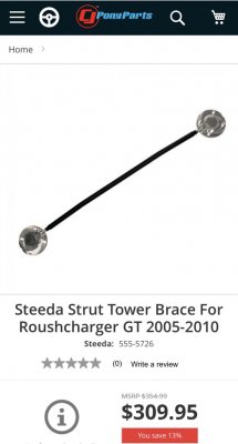

LOL I was just trying to see how to respond...let me see what I can find out. I have not heard of anyone doing this but that does not mean you can't. BTW where did you find that tower brace? My Ford Racing one won't fit anymore. Marc
Laga
Aug 10, 2019
991
518
Chicago
F042531D-7D12-4BAF-A877-302B0EAA6CC2.jpeg F6A8D412-BB7C-4E8E-B2AA-1CA7AB399FCF.jpeg That one came from CJ Pony. I have a used Boss 302 strut tower brace that I had before. Let me know if you’re interested.
