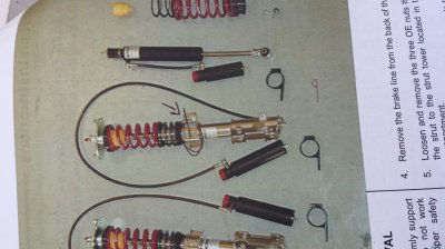

Thanks for the post, the issue seems to be more complicated. I'm rubbing with a 275/35/18 tire on an ET43 18x10 wheel which doesn't make much sense to me as a 43 offset is standard Mustang offset and my tire isn't even all that big. I know of people running a 305/30 with a similar wheel. The rub is so bad I need a 10mm spacer just to clear and would likely need 12mm for hard cornering and lateral tire movement.
Attached is a picture if where the rub is.

That is quite strange indeed. I use the 18x10 +42 Forgestar F14's from American Muscle with 285 RS-3's for the street and I only needed a 5mm spacer. And that's only because my AST's were slotted and I pushed the camber all the way in at the strut. Are your tires coming close to the strut body or the springs? On mine the spring is completely above the tire.

The tire is completely rubbing on the part shown in picture. It's rubbing so bad that you can't put the wheel on the hub and have it sit flat, when you tighten the bolts it gets even worse.

I think PART but not all (if you're rubbing as bad as you say) of your issue might be because of the swaybar bracket collar. Note how thick the collar is compared to the strut body itself (and this is not knowing if the strut housing itself isn't already larger diameter than a stock strut or AST type).
The older AST 4100s I use still have the clamp-on style swaybar bracket like the one seen here. These are a lot thinner and is almost flush with the strut housing.
Other folks with AST's responding to your question probably use the newer AST 4150s, which have welded on brackets that are flush with the strut housing just like on an OEM strut.
The theme here is minimizing the thickness of the strut housing for tire clearance. I think Eibach may have forgone that extra bit of clearance for a beefier swaybar bracket without having to weld them on. I think the 40-43 offset range may be ideal for 18x10 on this car so I wouldn't go with something like a +30 wheel set up to create in-board clearance on the front as the rears will poke out quite a bit. In this case a a big spacer may be the only solution for your wheels' offset. =/

I don't feel like digging up the picture, but Gmitch had to do some cutting on his R2's somewhere in the vacinity of your yellow circle there I believe. There is a pic of it and it is in this subforum. Think he was running larger than a 285 too. Don't remember his offset.

All, great news here - with your responses and guidance (I forwarded this thread to my tech) and he just called me saying he adjusted position of the knuckle and the wheel clears without a problem.
So Apex wheels 18x10 ET43 with a 275/35/18 fit without an issue.
