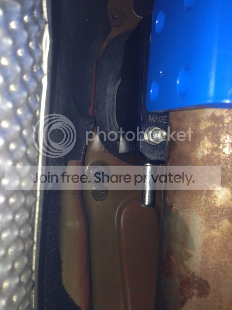

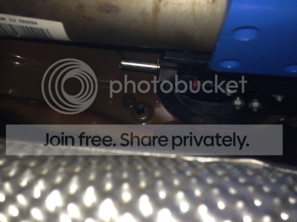

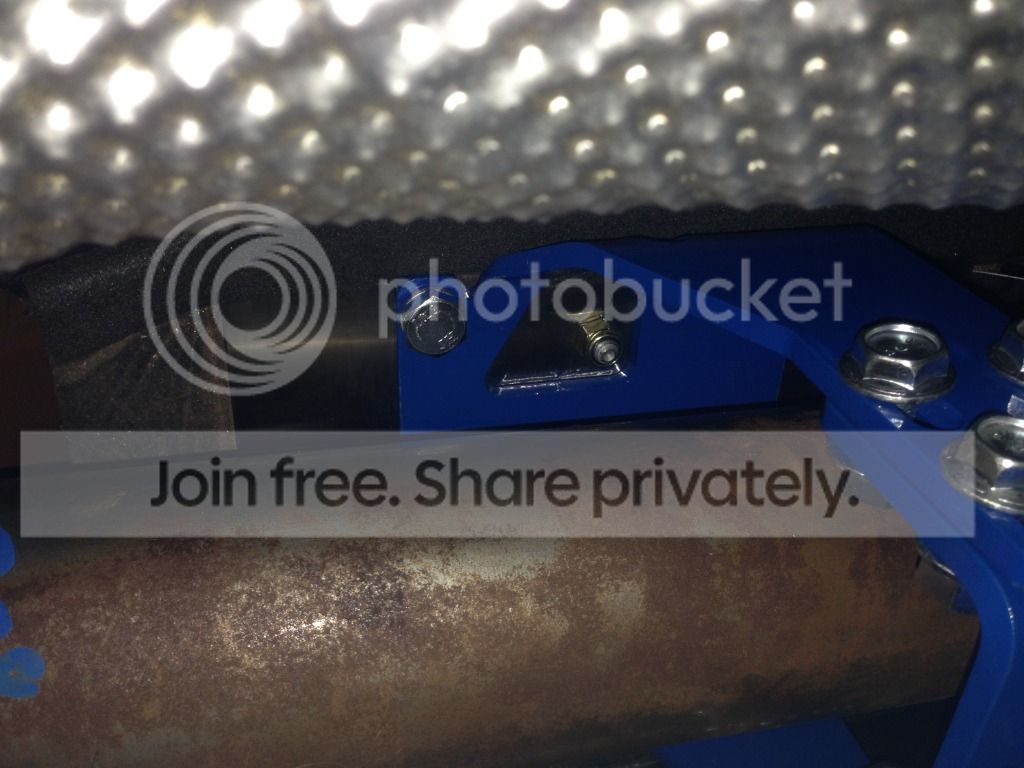

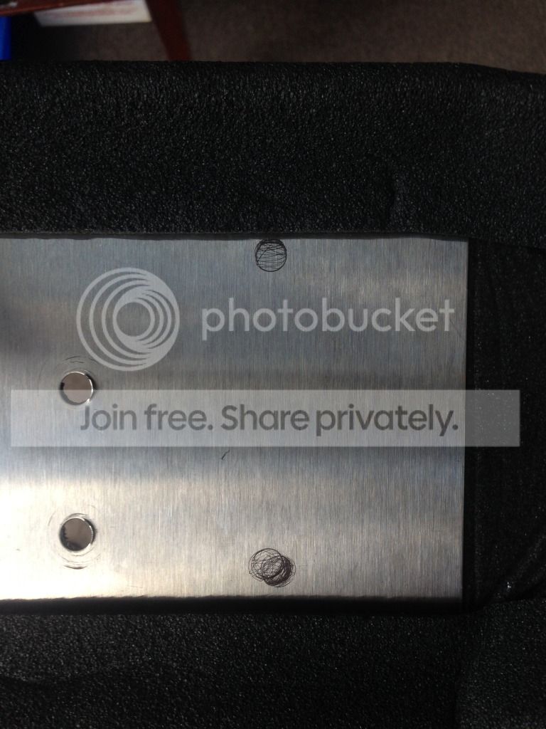

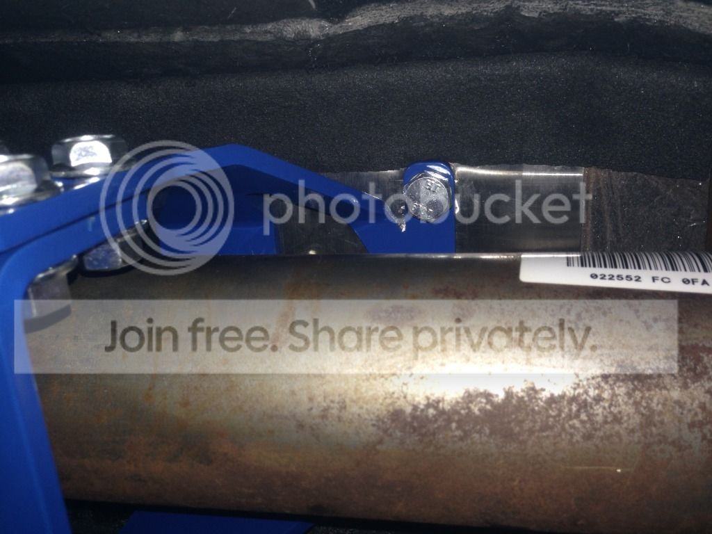

AAaaaaaaaaaaaaaand this is how you do it CORRECTLY!!!
Scribe the holes on the heat shield from the upper portion of the BF bracket for drilling.
Put rubber hose over the frame studs to keep the vibration away between the studs and rear shifter bracket
Holes cut/drilled on the heat shield and noise cancelling material from the MGW package
Assemble BF bracket AND MGW Heatshield/noise cancelling matte.........NO PROBLEM!!

I was befuddled at the orientation of the new shifter bracket adapter with the BF brace. The OEM one bolts to the floorboard whereas the BF Shifter bracket adapter bolts to the MGW which hangs suspended until bolted to the upper portion of the shifter bracket.
The shifter height or adjustments that can be made by pushing up or down on the bottom of the shifter and then bolting them down has me critically thinking on where would be the best adjustment of the shifter before securing it in the desired place. I have mine pretty much all the way down and it seems fine.

Mine ended up almost all the way down but it was rattling against the factory stud in the tunnel. I had to pull it all the way down and slightly cock it to the back in order to clear the stud and get rid of the vibration.
Exactly where mine ended up to clear and not make contact.
