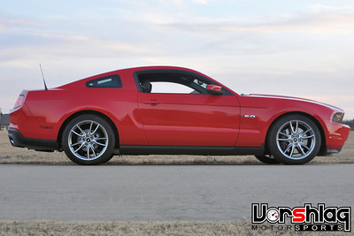

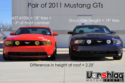

Has anyone had any shimmy problems after installing aftermarket wheels? I really have not read about any problems.
Our 2011 Brembo GT does it with the stock 19x9" wheels and tires plus any of the other 18" wheels we have (two sets of 18x9" + 18x10"). We didn't experience any of this before the car was lowered, however. That may or may not be relevant.
I recall reading that the Ford EPAS can make adjustments for out of balance wheels. This makes me think it may be a malfunction of that system/ECM logic. Dumb question I'm sure but with the significantly smaller tires your running is the revs per mile properly set? I would assume that system would have to use wheel speed one way or another.
Again, we've had it happen on the stock tires (255/40/19), and several other non-stock sizes we have run on the car (275/35/18, 265/40/18 & 265/35/18). So far it looks like tire height makes zero difference - in the same corners it will shudder violently.
We have an SCT tuner with custom programming that can compensate speedometer for various tires sizes. And before you ask, no, the SCT tuner/software does not alter anything on the EPAS system, that we know of. The steering shudder was there when the engine calibrations were bone stock - before we added the tuner/CAI - too.
I'll report back after we have Ford flash in the new software for the EPAS (the TSB).
