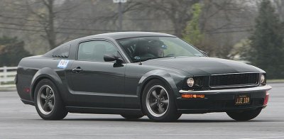

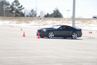

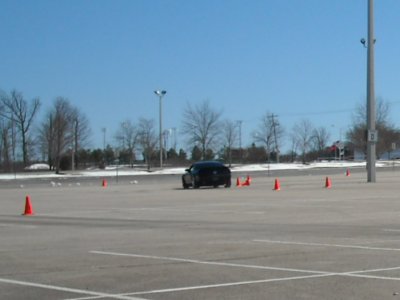

Me and the wife went to our Local AutoX today, wasn't expecting a lot since its been over 7+ years since i last Crossed and that was with a FWD Saturn.
before i go over how the day went i want to give a quick break down of my car.
2009 GT
Eibach Sportlines
GT500 Strut mounts
BMR Adj PH Bar
BMR PH Brace
CHE LCA's
CHE Reloc brackets
UMI Adj 3rd link
Roush 20x9.5 wheels with 285/30 Hankook v12 tires
FRPP 4.10's
Stock Shocks & Struts (I KNOW I KNOW!)

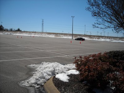

weather was fair but we had a semi damp track from melting snow.

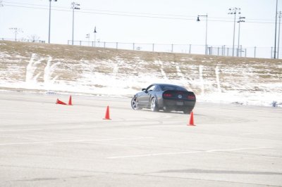

car did ok, had trouble getting traction in the straights and exiting hard corners (ended up doing the course in 2nd 90% of the time). Car pushed bad in deep corners till i got to around 15ish MPH.
ON A BUDGET what would be a good start of mods?
Shocks & Struts?
Steeda X5 Ball joints?
Caster/camber plates?
Sway Bars?
when i get the videos processed and pics downloaded ill upload them so maybe a better trained set of eyes could see what my car is doing...
