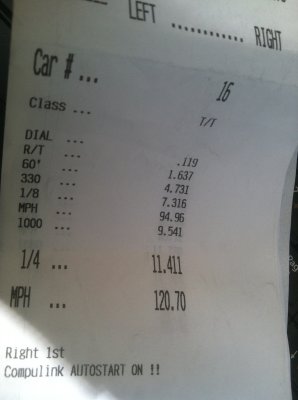

Testing was done at the 10/18/13 MIR track rental, Car is a 2014 Gt/CS A6, Fully loaded down to the navigation and power passenger seat. Only mods are
CJ intake manifold
SCJ Throttle body
Home made 5 inch CAI
JLT catch can (passenger side)
DSS one piece ds
Lethal off road H
Circle D 5C converter
Race star wheels (15x10 275/50/15)
Sway bar disconnected
Suspension is 100% stock
Only weight reduction was removal of the strut tower brace, Everything else was still there down to the spare tire.
Started the day off with a [email protected] (-23DA) and after a few tune changes ended up with a [email protected] (+480DA). Shift points on the .23 pass were 1-2 7100/ 2-3 7600/ I think with getting the 1-2 shift higher and changing some things were the converter locks should pick it up another tenth.
I wanted to test the factory IM at the same time along with a 4 1/2 CAI for CJ IM but we did not have enough time. But i will do that another day here soon.
Comparing these times to some of my other customers Boss intake combos i am still unsure if this manifold is worth all the extra money over the Boss, I do believe the CJ manifold does make more power though, Once I do some more testing with it over the next month i will be able to come up with a better answer to that (Only in my opinion).
This is not a very good comparison, but the car had been a best of 11.63@116 in +222DA with the factory manifold and factory air box (different track, different days). The only mods for this pass was the converter, off road H, 275/40/17 drag radials, and the sway bar disconnected. So i added quite a few things along with the CJ manifold.
I am not trying to set any records here, there are a few guys out there going way faster then me, I just wanted to share the times it ran at the track rental:beer:
Below are a few videos and the worst and best time slips of the day.

Would you be able to test the Boss and CJ on the same day? Do a couple passes on the Boss, repeat for the CJ.
Either way, that is pretty badass time!

Those are very nice slips Mike. I'd say you have a good handle on the 5.0! What's really amazing is how few mods were done to get those times. I'd imagine you have the tuning down pat.

FWIW - I believe the GT500 TB with the CJ intake is a restriction over the Boss with the stock 80mm throttle body. I have been testing both setups against each other and my car ran it's best last night using the Boss intake.
I believe to see gains over the Boss intake one must use the mono-blade SCJ TB. That said, my plan is to procure a mono-blade SCJ TB and test with the CJ intake more.
Nice passes and good luck with your continued testing. :)

That is the plan, I have a customer that is going to lend me his intake (Boss) for some upcoming testing. I have some numbers to compare with already, but of course different days at different tracks and different cars, So the data is not 100% accurate by any means. From what i have so far the CJ is worth about .07 and about 1mph over the Boss. Only way to tell that for sure though is to test back to back as you mentioned!

Thanks man! I dont have much data for the GT500 TB vs the SCJ, But i do agree that the GT500 is a restriction for the CJ IM, I have only done one dyno test on them and the SCJ did see a peak 6hp increase over the GT500 on a different car on different days.
I am going back this Friday to test out a few tweeks and the corn. Hopefully there is a 10 sec slip in there for me!
