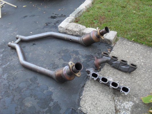

You'll need an H pipe with a connector like in the below pic for those headers..
