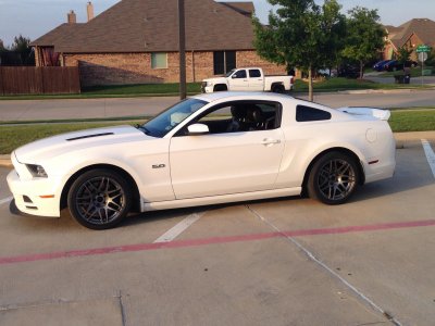

Haven't posted an update in a while so here it goes. Haven't had a chance to make it to an event yet but I slapped the Hoosiers on for a test drive last weekend. Holy. Mother. Of. God. No wonder it's called purple crack. Even on well worn and "cold" tires I've never experienced that type of grip. I'm happy to report I didn't get any rubbing in the front with a 3mm spacer. It pushed the 18x11 and 315 tire out just enough. Sadly I did find an oily residue on the driver side hub so I'm going to replace them both with the ford racing units with arp studs just to be safe. Anyways. Here's a photo.
