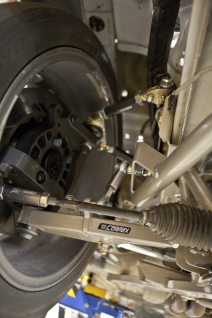

HEY HEY HEY, Cortex has an SLA kit as well and I would argue quite heavily that the uprights he uses are superior to the Griggs/A47 kit.
Here are pictures from the Performance Autosport AI car:
And of course some YouTube love of their AI car going around VIR. About 30 seconds in the video of the front suspension shows up int he lower left:
To my knowledge these kits are custom made and you have to call to get them from Filip. The uprights are what he uses for the Fox/SN95 cars as well and they are pretty pimpy looking and have a solid track record from what I've read:
Putting an SLA kit on the front of an S197 is like filling your in ground pool while your house is burning.
