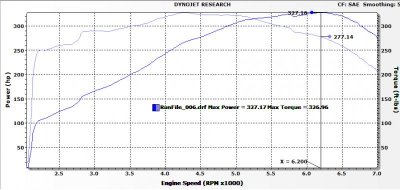

Heres the dyno sheet pulls good to 6800rpms
